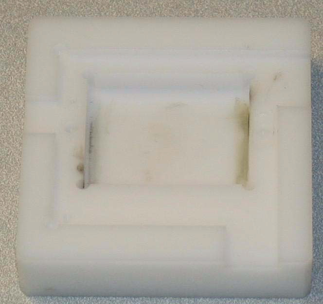

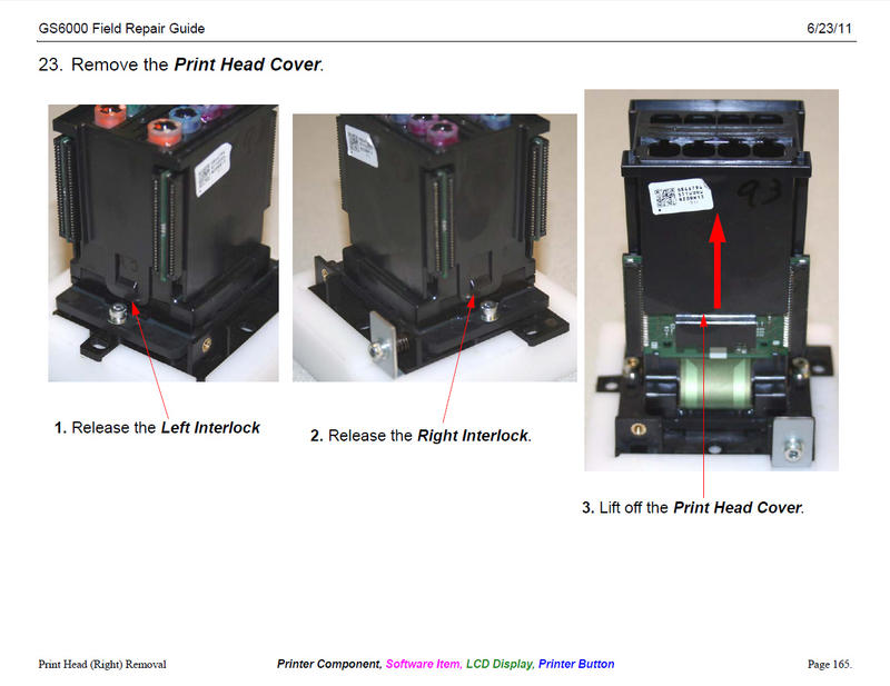

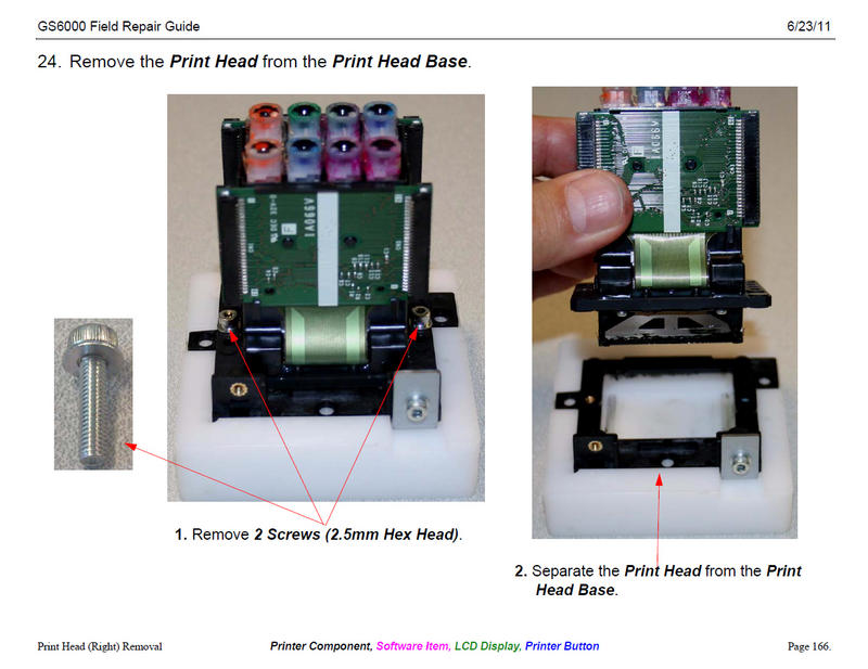

First wanted to greet all fellow forum , for some time we have a GS6000 Epson ago and we are studying the possibility of replacing ourselves printheads , we have manuals fairly complete technical service, program service program for subsequent adjustments but we lack a piece that is essential for the adjustment of the heads is optimal and not a nightmare . I attached photograph of the piece if someone can give us more information about it. It seems to be a milled basis with the right size for the head can be inserted and this menera height adjustment and alienated perfect . Someone has experience or has been able to change this piece without calling the service technician . Thank you very much and greetings to all . I think we looked impossible but we will try .

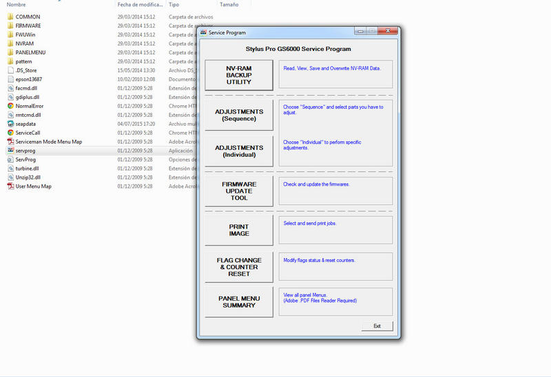

I dispose of the program, called " service program" but I have my doubts if I should connect with Epson platform to use .
