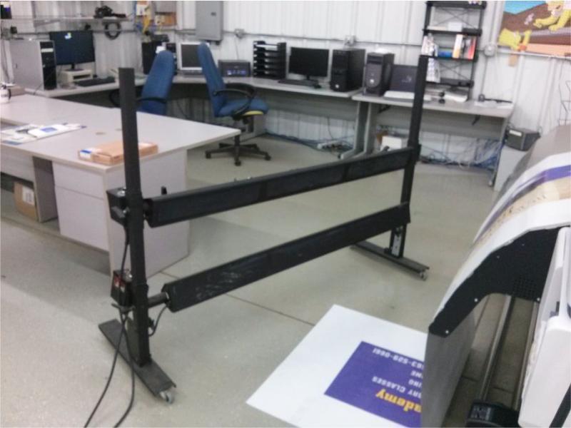

for higher speeds, we use 2 older bbc digi dryers (see pix) we never print 2 pass, but find the extra heat necessary for 4 pass high.
