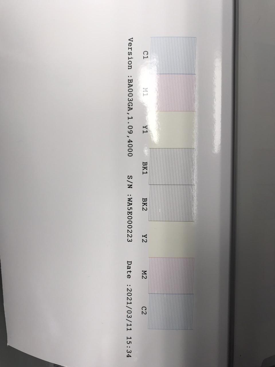

Good afternoon, we've been having problems while cleaning the heads of our Epson S40600, the problem is that the nozzle check doesn't appear complete, we have some holes on the proofs. I attached a picture of it. Is there any recommendations we may try to fix this problem?

That is a good nozzle check and will likely go to 100% after printing a little bit.
We regularly shake the ink cartridges and do a head cleaning, after this we make the nozzle check. Almost 1 time each month we do a deep cleaning on the machine parts, but we haven't got lucky with those small dots that are mission on the nozzle check. Is there any tip or idea you may bring up to resolve this problem

I would clean less, and print more.
The less you touch these heads the better.
Is it always the same nozzles that are out? Those few nozzles missing wouldn't be seen in any print - in my opinion.

Yes always the same nozzles, they don't actually are seen on the prints but we make the medium cleaning and the nozzle check before we print anything, because we've had some problems with lines across the prints. Any idea of how we can fix this nozzle problem?
