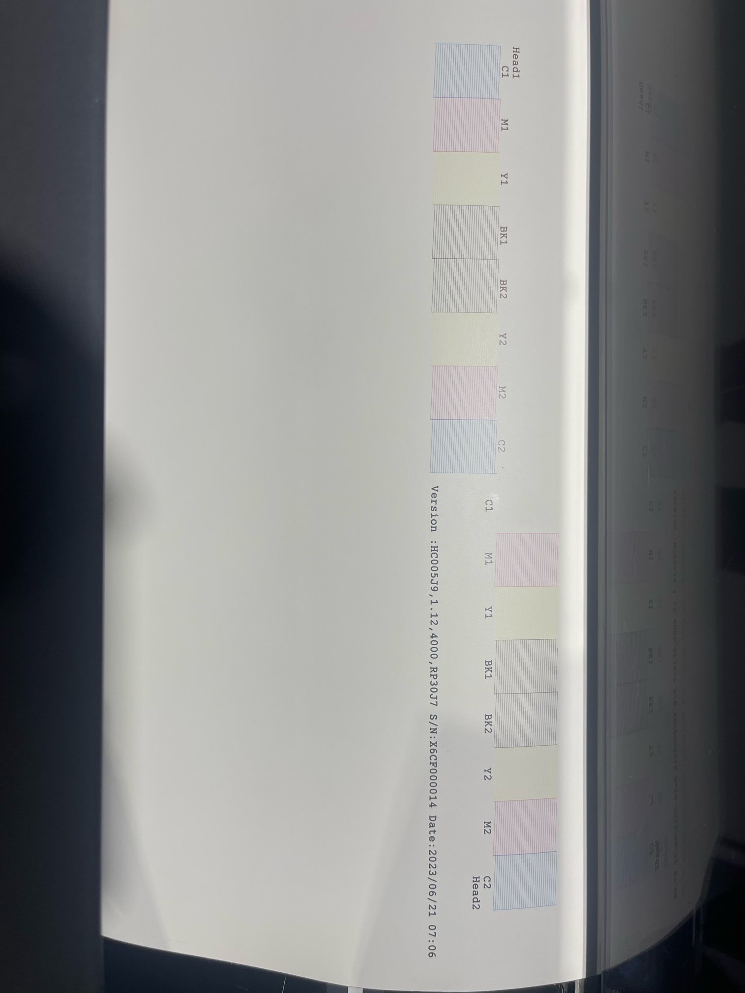

I was trying to print out a past job and noticed that my blues were not clost to what I had before. I figured out that it was because an entire nozzle isnt working for cyan on print head 2.
Any idea how this can be fixed without replacing the nozzle. Ive done a manual cleaning and several head and nozzle cleanings.
any suggestions would be greatly appriciated

Not much you can do besides replacing the head. You can switch to 1 head mode and only print with head one. It'll be slower printing, but you'll be able to print until you decide to replace the head.

Thanks for the response. I talked to epson and thankfully they will replace it under the warranty. Do you know what could have caused this? I didint have anything happen just been printing regularly

It can be as simple as a short in the cable to knock out a part of the head, but that normally would affect more then one color. Could just be a faulty print head and it finally failed. One thing to do is make sure your machine is running off a UPS, so if theres a power surge, even a little one, it'll help protect your stuff.
