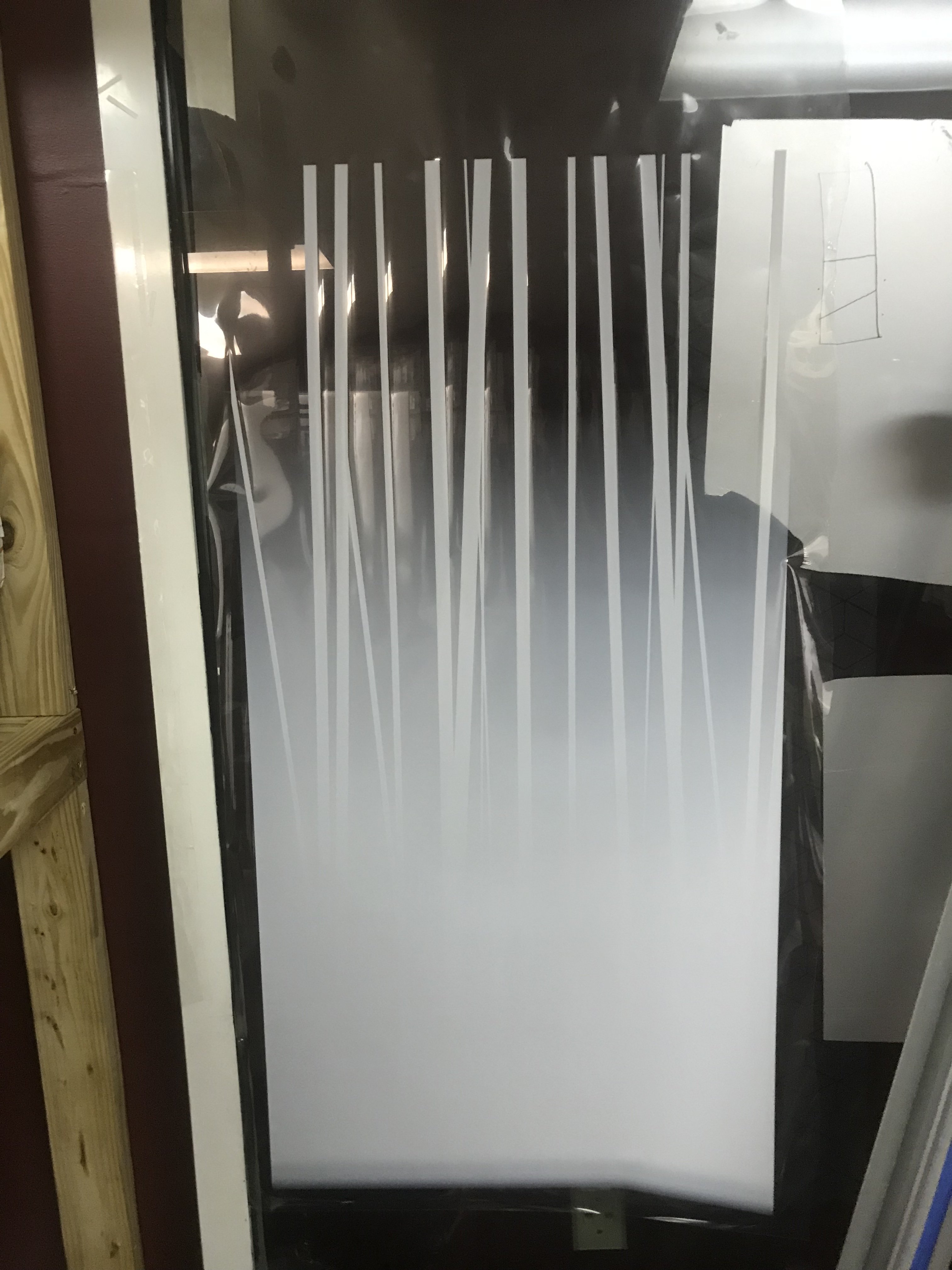

I have an epson s80 Printing way is pretty straightforward, you have to make a swatch in illustrator or whatever vector-based program you’re using that says “Spot1”. I have done so and gotten the printer to print a beautiful gradient along with white grass. The challenge today was I am trying to experiment further, I don’t want just solid white I would like some off-white, some creams, a grayish white. How is this possible with the S80, asking it to print a spot color shows no luck. I am willing to share the file I was playing with if anyone could be any help that would be awesome currently I’m in the dark. Also what is the general life inspect and see a print a also what is the general life expectancy of a printhead if taken care of. Printer is currently sitting at about 750 K square feet .
peterosoiro94
White gradient preview.

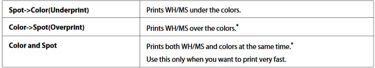

You cannot make it mix any color with the white. So if you want to print pale colors on clear, you would set it to print multilayer in your rip and put an underlayer of white below the color you have specified in your layout. It will then print the white underlayer, pause to dry, then roll back the vinyl and print the colors on top of the white underlayer.

ok, is it possible to print color at the same time as spot, or must it wait for into to dry and then go back over it.
No. If you print at the same time, the inks will mix while wet, rather than layering. On the Epson the drying time is only 30 seconds before it rolls back and prints the next layer. The slow part is not the drying time; it's the high pass count that's required for printing white.
