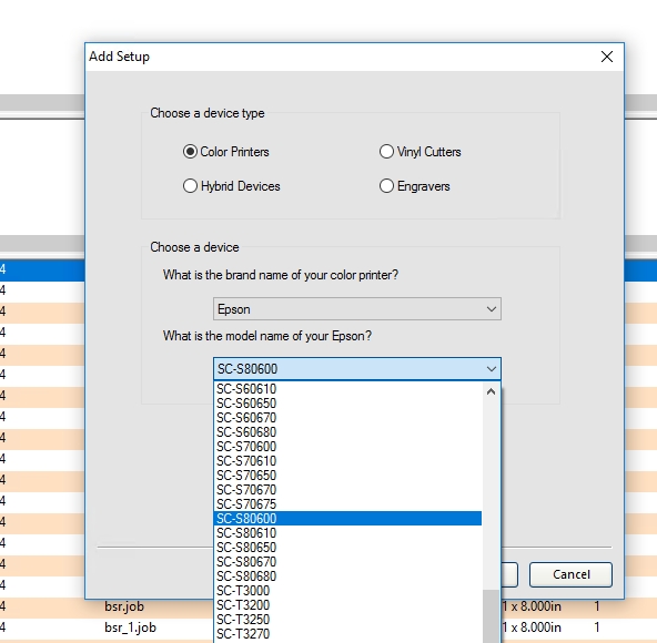

So does anyone run Epson printers on Flexi CC. As we have more experience with Flexi than any other rip software. We do not design with it only rip with it and for the lower monthly price and it always being up to date in my mind it might be worth it to stick with Flexi CC rather than change to lets say postershop. I didnt realize Caldera was linux or mac.
Just curious on the S80600 if it handles the extra ink channels correctly.

At present on the Flexi website they do not show it as a supported printer. Odds are that will change, but if it was me, I'd take now as a good time to migrate over to Onyx.

The website is way behind lol. I did install the printer on flexi as it does show compatable. I would need flexi print shop so adding another 2 grand or so. I have been using flexi for years but i do not design on flexi i only rip and layout with it.
Was just hoping to find someone who has the same combo. I run CC version of flexi so it is always up to date and the newest version.
Thanks for all the replys. Right now we are just getting everything in house and going and was hoping to not have to change software lol..

Just if anyone wants to know Flexi CC and Epson S80600 together are a complete nightmare. 3 weeks into this and we now have onyx and was able to set up and print an amazing file in less that about 30 minutes. Granted i have no idea how to use Onyx so i just opened in rip and printed. Not even sure of what profile was used lol...
Flexi has devistating color correction issues and even more issues when you try to use the software day after day with changing color....
