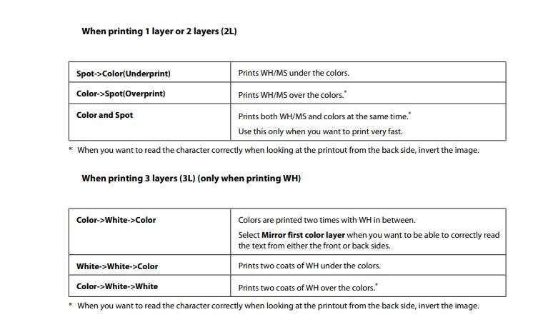

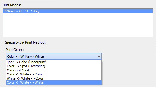

...and I just found it. You need to look for a profile for backlit or frontlit media.
All of the options are in there. See my next post for a screenshot.

We make our own profiles, so I just kept going through all of the settings until I found some that had the 3L option.
Unfortunately our machine doesn't have W or M, so I don't have a working profile I can share with you.
