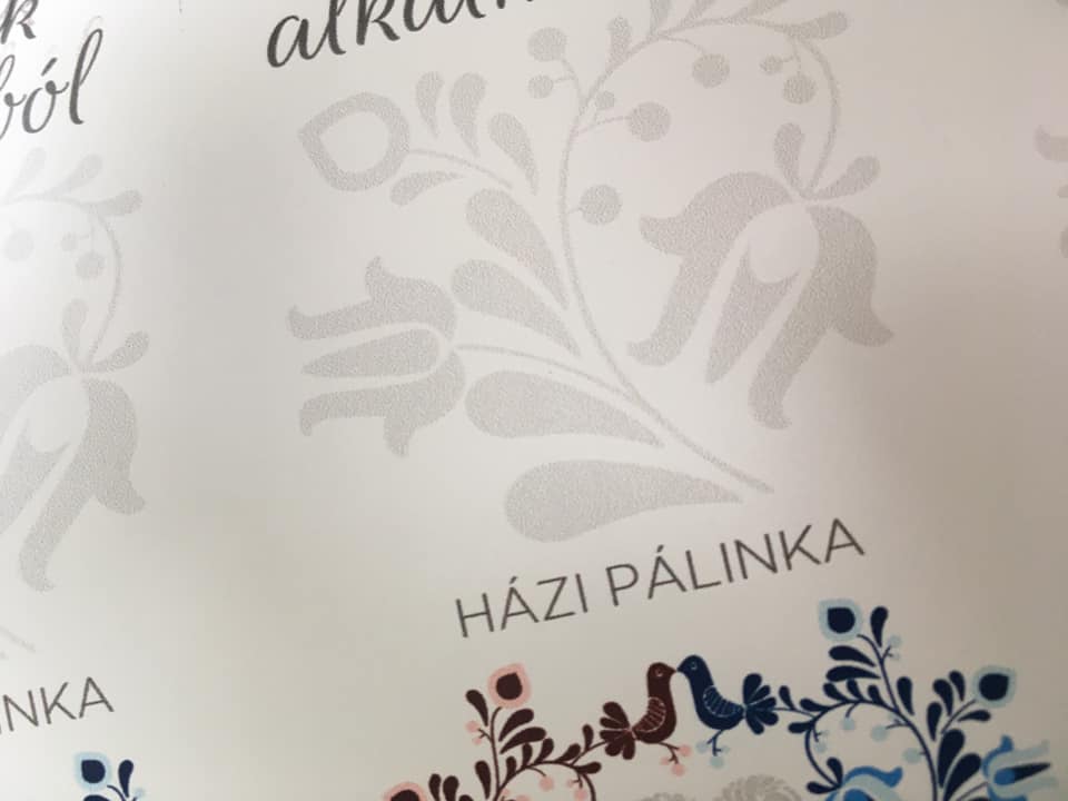

We boght today a epson sc40610 . We hove some quality problem .Maybe sombady can help to us.
So if we printing from Onyx the print is grainy , but if we print from epson edge print the quailty is more better but not perfect. How can we set the Onyx for good result , because we need the contour cut option.
We using intercoat matt vinyl and politape 4033 heat transfer film

What sort of profile are you using? How many passes and what resolution?
This machine is capable of very high quality prints if set up correctly.

we usually tried the 8 pass 720x720x1440 ,but the result with 12 pass uni direction print with same . We would like to print on monomer matt vinyl but we haven't line sharpness. All print is blurry . We tried to print glossy vinyl and the result much better.

Veja se tem um perfil para sua marca de vinil...
I think that is a bad config of the dryer
