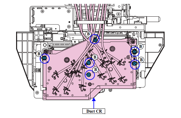

What is a damper?

What is a damper?
It's the ink delivery system that sits on top of the print heads. The one with the ink lines going into, it's also called Duct CR just used to calling it damper from older machines.
