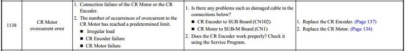

Error 1138 on the S30670? Anyone know this one?
Get Lucky
This is what the manual says about it. My guess would be it is time to replace.
