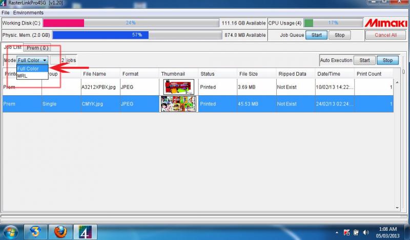

Hi Mike d,
In rip software check the options i.e Mode are two type 1st one is Full Colour,
2nd one is MRL. IF u Choose MRL Machine will give MRL command error. We should use "FULL COLOUR"
Find attached file and look in Red box
We are using RLP RIP which is given by mimaki, i did't check in wasatch soft rip because I don't have copy of wasatch soft rip
