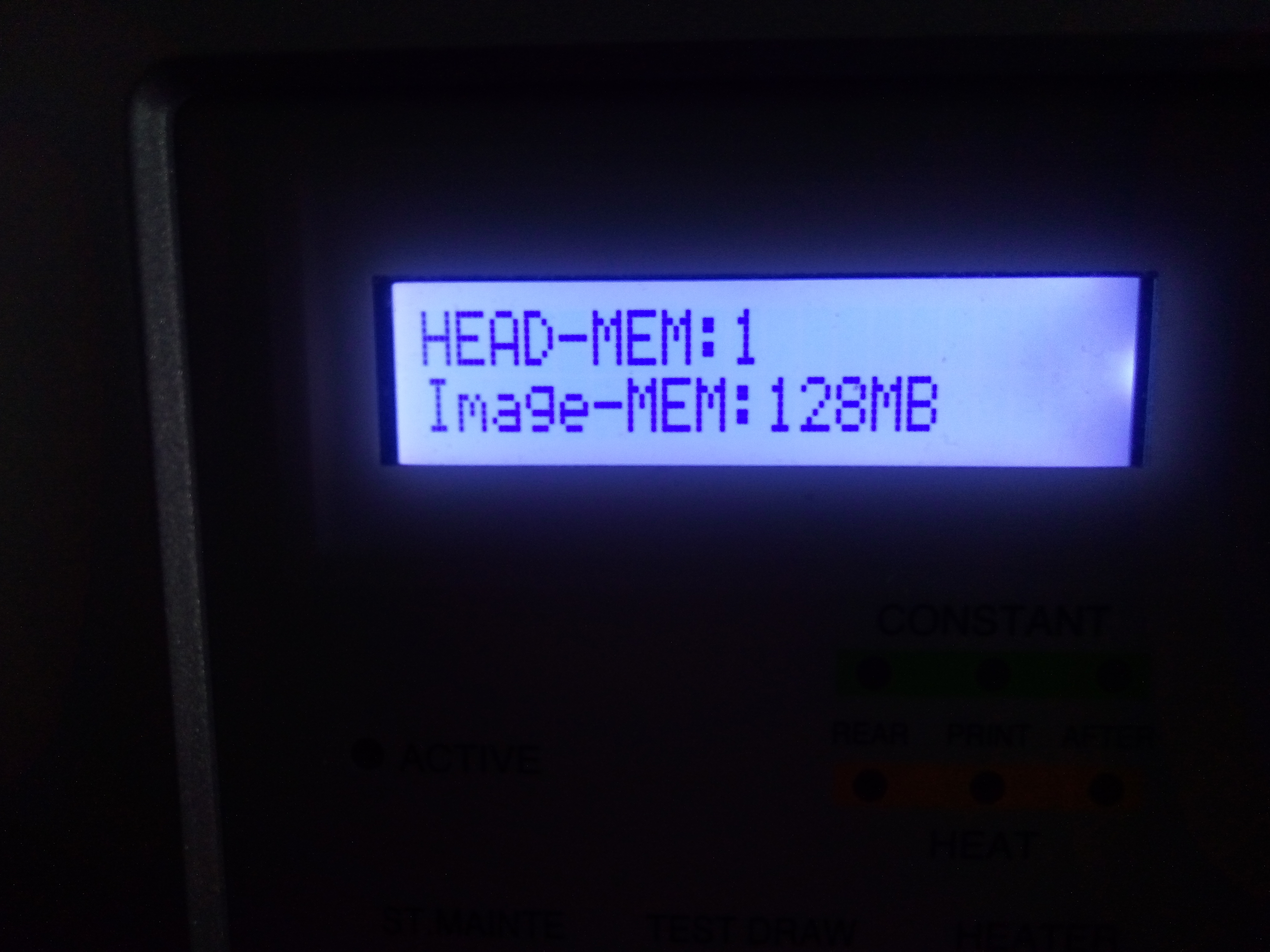

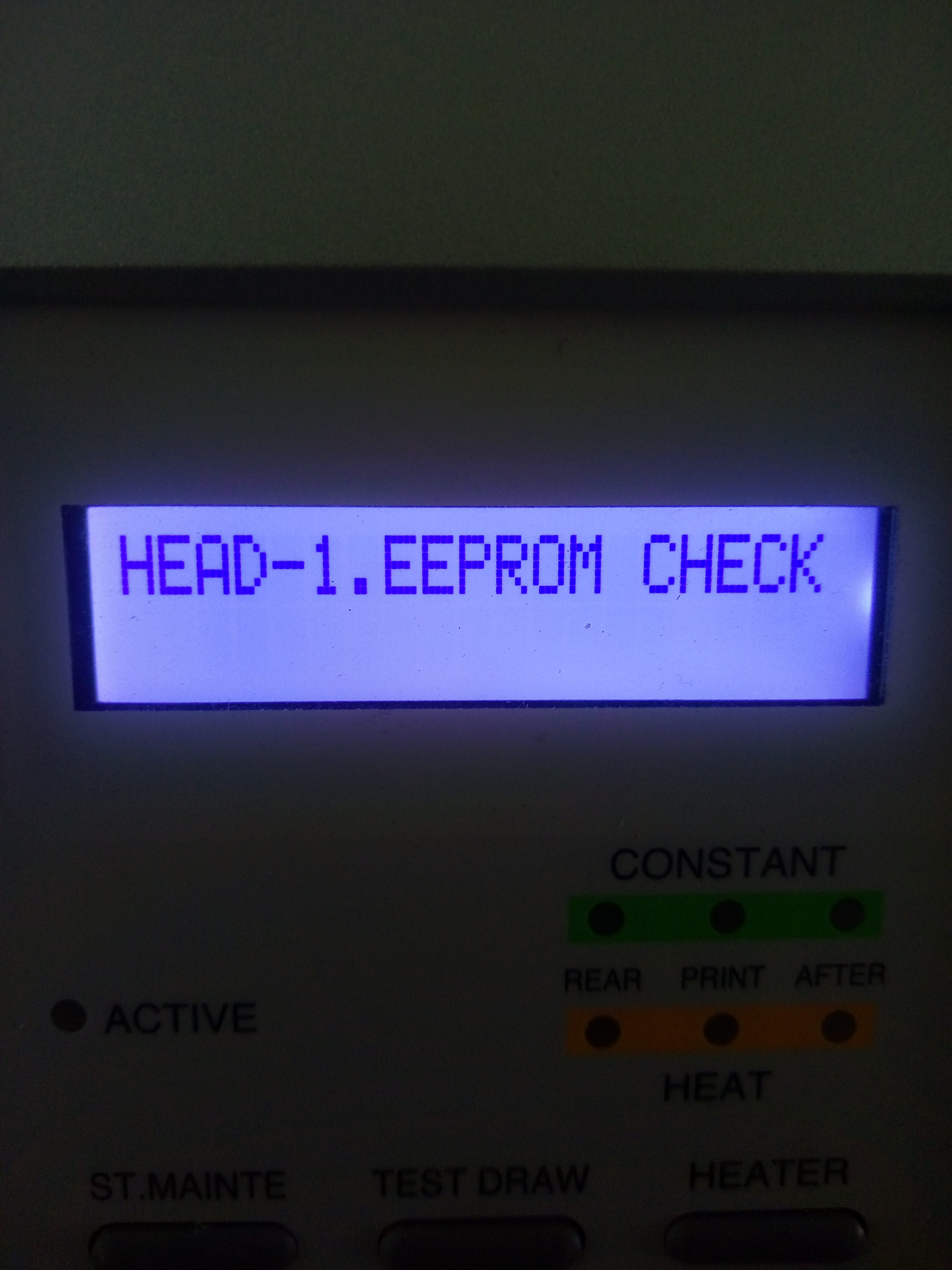

PJ758
I have a Mimaki JV33, sometimes show Error 200 but after switching off and on again worked. At the time the error 200 returned and can not longer use the machine. According to the Maintenence manual recommends the following tips:
1. check the head memory cable
2. replace the headmemory
3. replace the ink slider pcb assy
4. replace the ma pcb ssy
It would help to know if before the replacement of the recommended parts there is some other test to do? And what insurance site can buy these pieces?
I'm getting this errror changed head memory, changed head cables, what would be the best option pcb slider board or a main board?
