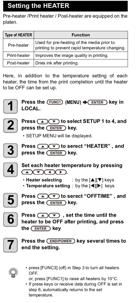

Now I would like to change the heater time setup for heaters to switch off when printing is done as my settings are that heaters will switch off around 15 or 30 min after printing. Where can I change this time setting please? tnx

Excellent, glad you got it fixed! See the attached instructions from the operating manual for heater settings.
