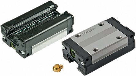

maybe i know why...
I take off the 1 rail (photo). In back side head have 4, now only 3 but machine work. We ordner new one. I hope this its the problem. Now its head for move soft.
