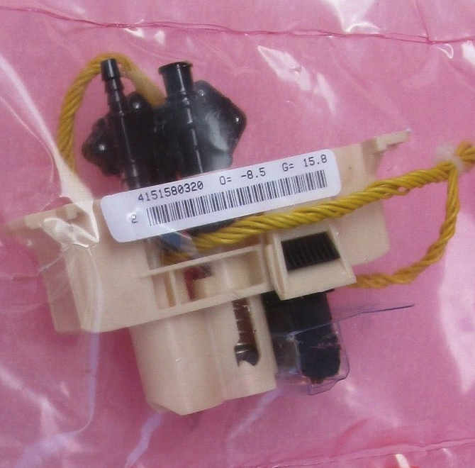

Take a picture of the label. The correct value is next to the offset and gain.

Looks like I don't have it - not on the antistatic bag, or it fell off somewhere since I opened it. I guess the part is useless to me now, or is there another way?

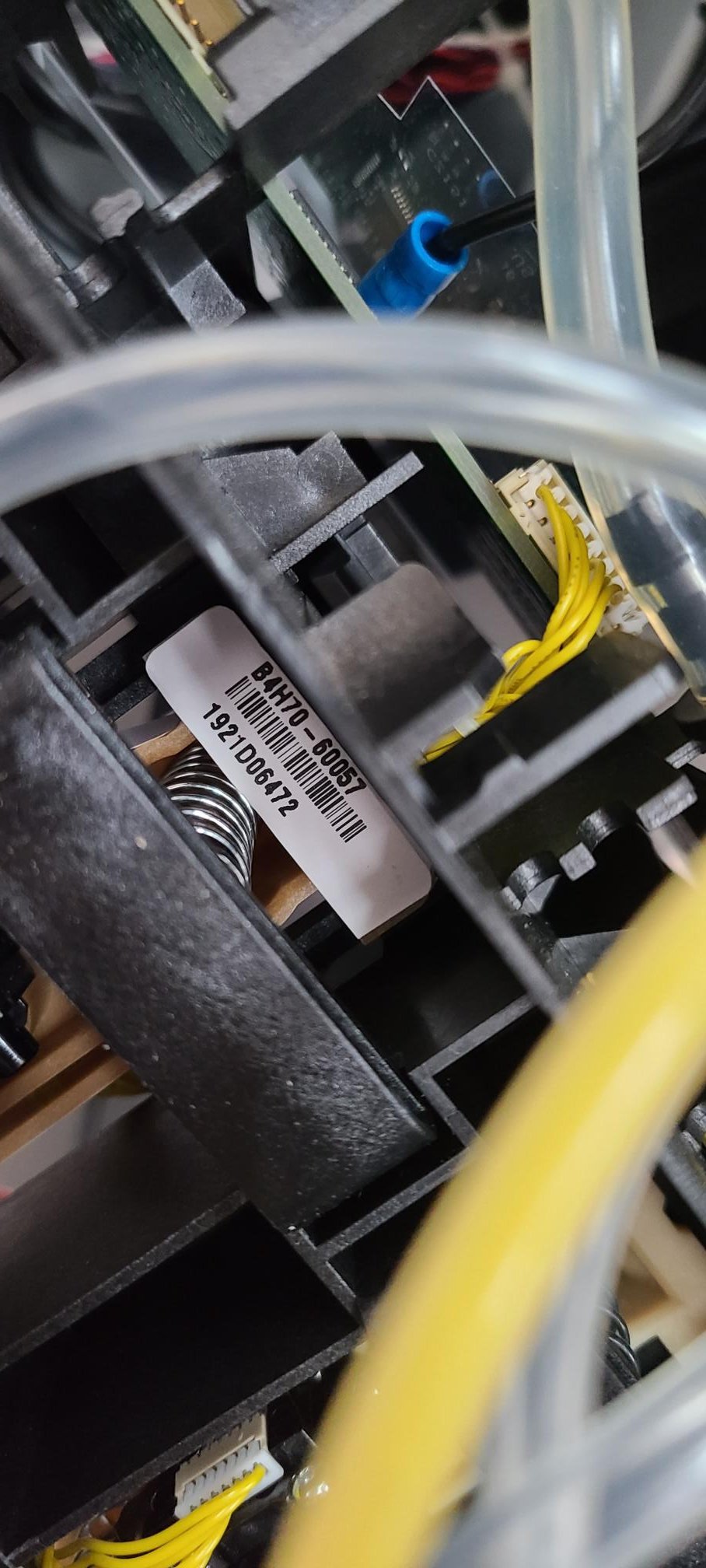

Oh man do I need a vacation - thought the label was on the outside of the package. I thought that was odd. I pulled the sensor and found the correct label. Entered the values and calibration says good.
