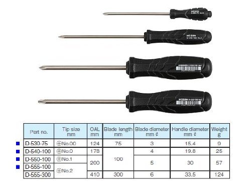

Thanks for the TIP, what did you pay for your jis screwdriver set?
What sizes id you get (that works on the Roland printer)?
I found a set of 4 on Amazon for $27.10 (see photo below), FREE shipping if I add something else to the order to make $35.
http://www.amazon.com/Hozan-JIS-4-JIS-Screwdriver-3rd/dp/B00A7WAHTU

I bought this set that has #1,#2 & #3 size heads and this set of small drivers http://www.mcmaster.com/#53325a21/=rv0ucq http://www.mcmaster.com/#53325a61/=rv0v0u
