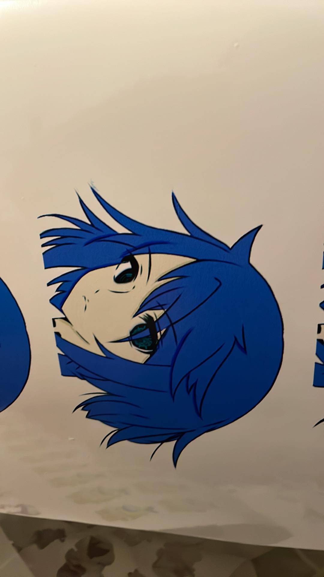

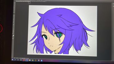

so i started printing my car after new heads were installed and everything had a cyan tone, (fixed it by adjusting curves) now im printing other things and the colors are completely wrong... attached are what it looks like in photoshop and illustrator and what i get from the printer... two very different colors

im using CMYK in both versaworks, photoshop and illustrator. im exporting psd from photoshop to illustrator (colors stay fine), then im adding the cutcontour line in illustrator and saving it as an eps, i have also tried pdf and the same thing is happening. test print is correct im missing a few nozzles on MY but not enough that its affecting anything else. The image on screen is being shown on a fully color calibrated screen on a drawing tablet interface. the color on screen is a lilac and the color coming out of the printer is blue. I have another example ill post later where the jpg file is fine color wise but as soon as i added the cut lines it acted like theres a transparent blue layer on it.
