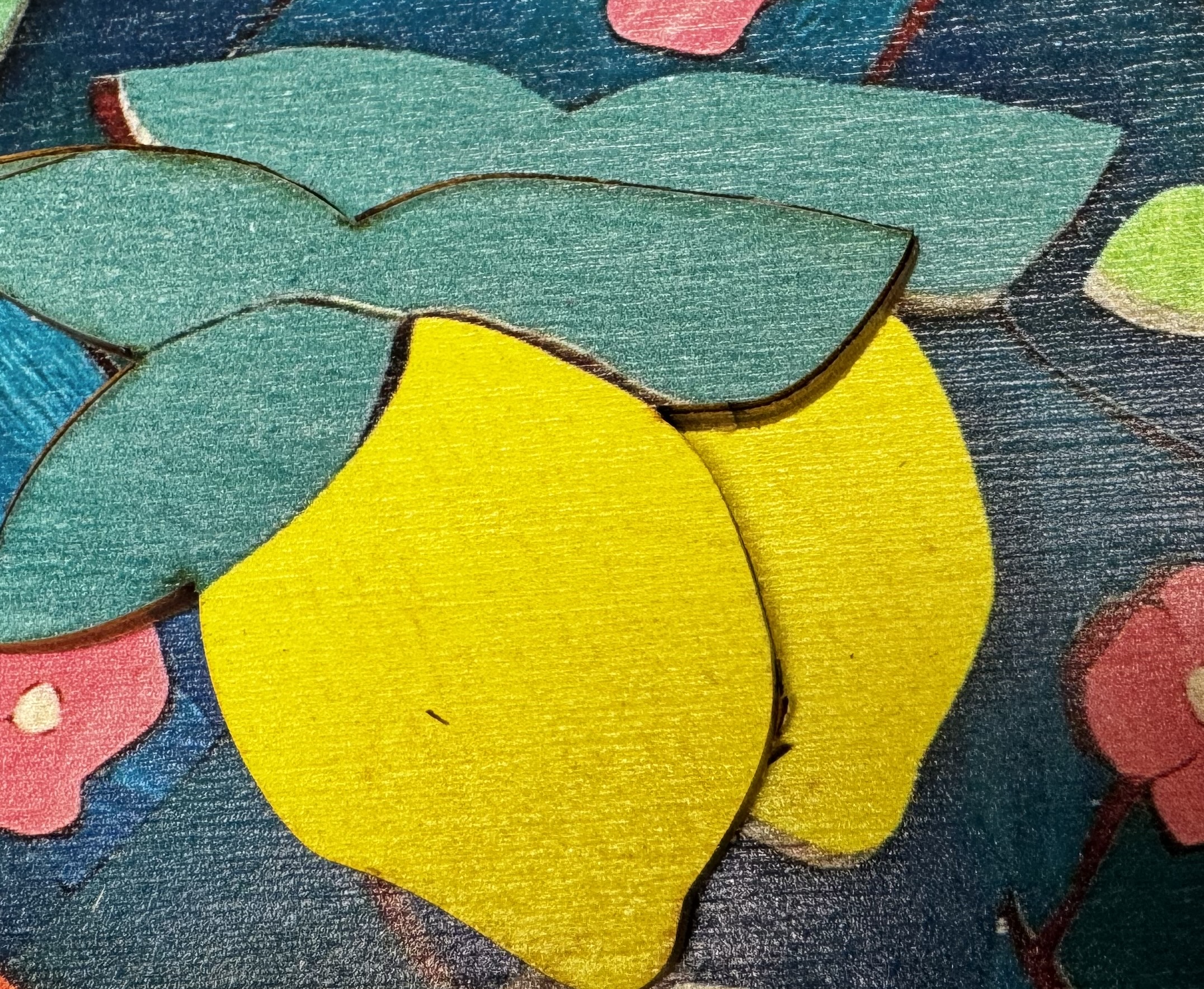

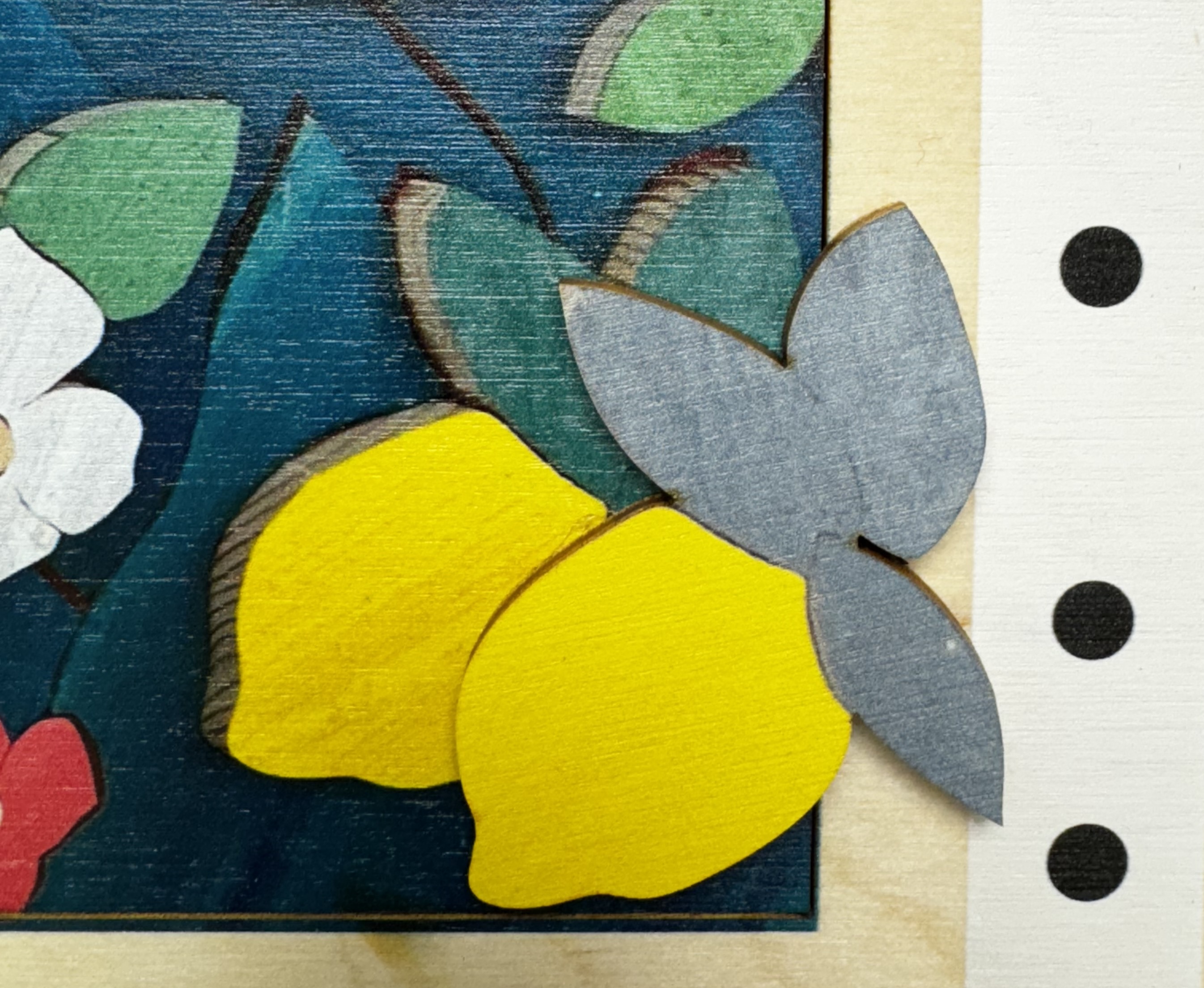

The first image is the cut part next to the background and it's spot on. The second one is another of the same fruit, but the leaves are totally different. That's the other strange thing, some of it is fine, some of it is not.

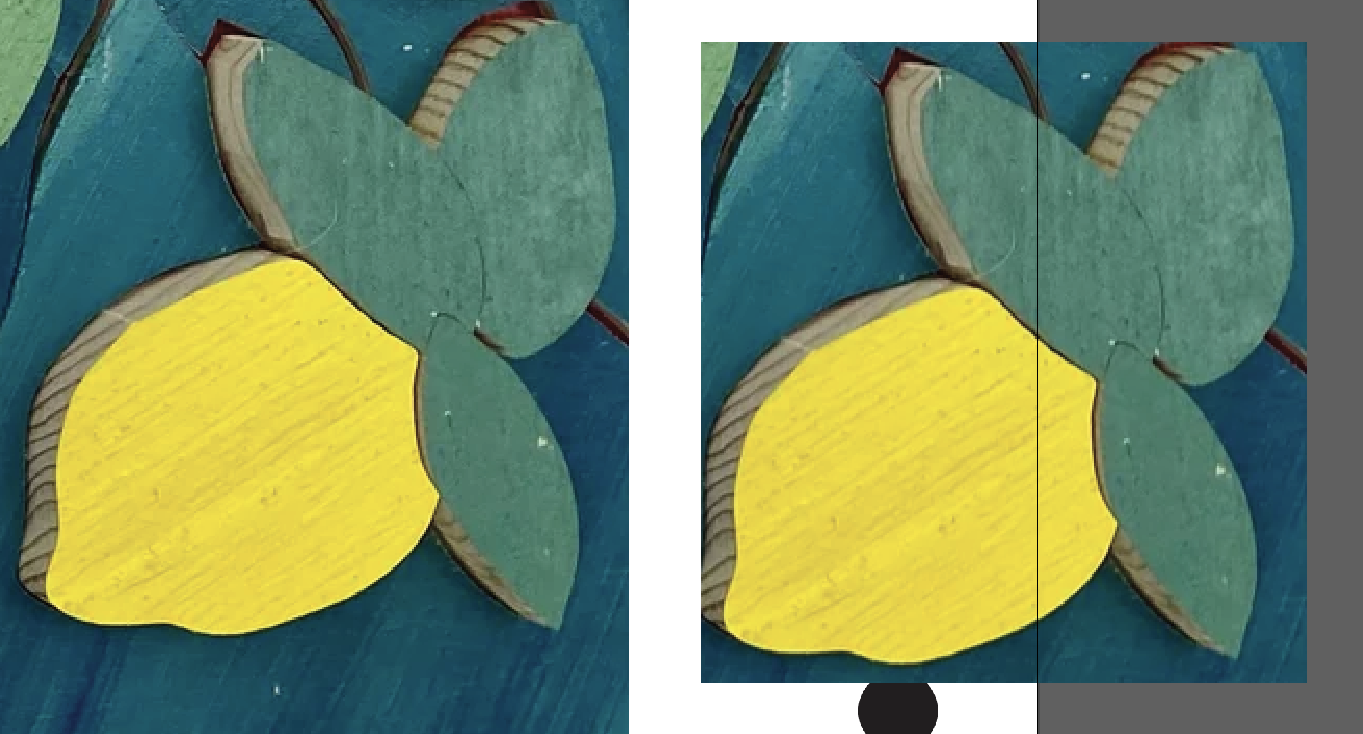

Basically, it's image slicing. You can draw in slices and export them as images (intended for building websites). Or, since many of mine were overlapping, I found that I could draw a bunch of artboards ("pages" basically) and do it that way. For example, if I have an 8"x8" artboard and I lay a 10x12" image over it and then export as an image, while checking the "use artboards" setting, it will output an 8x8" image composed of the part of the image that fell inside the artboard. I did the same thing, but with 41 pieces. The screenshot here shows the piece I cutout on the right, and that part of the main image on the left. This is one of the pieces that printed off color, the one in the photo above.

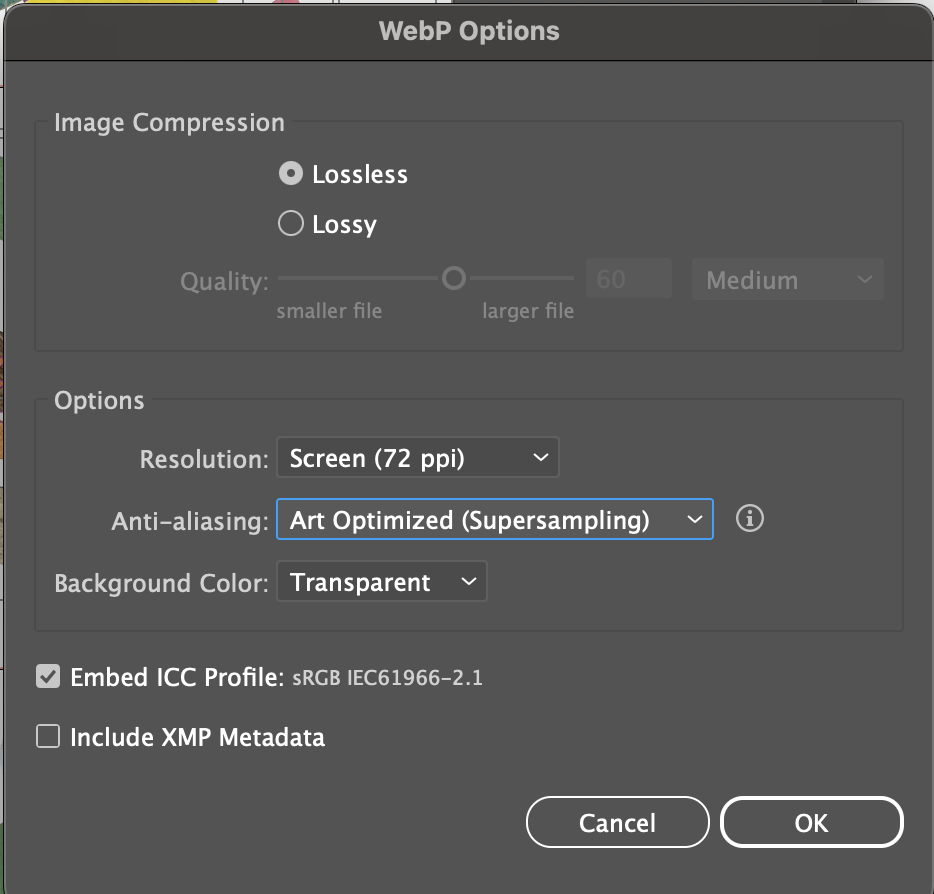

Ok, but what settings did you select when you exported the artboards? Because that's going to impact the print since you're exporting to image.

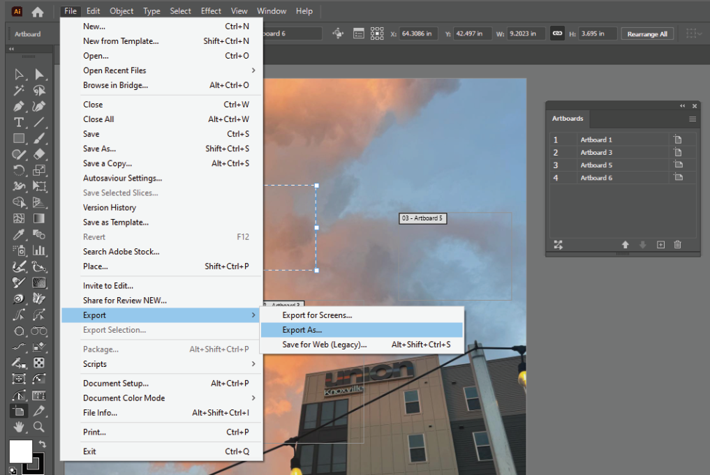

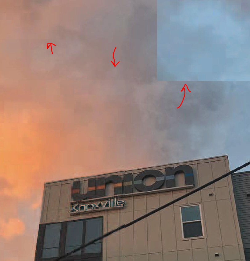

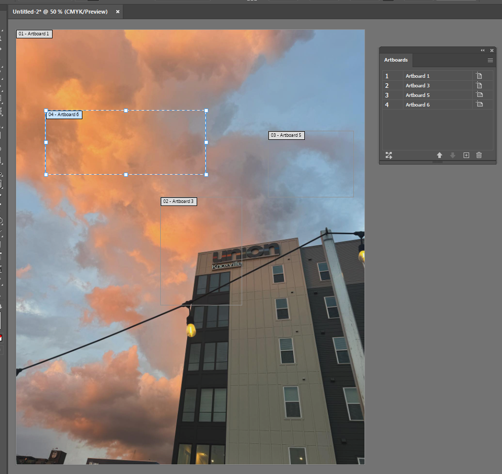

Example below - big artboard, I want to print some sections of this image separately so I add little artboards that are overlapping the big one.

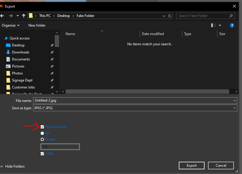

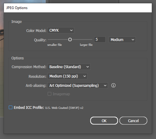

If I then export to image and select use artboards I have to confirm the image settings. (just using filler settings to show what can go wrong)
They may look fine when exported but depending on your export settings it can mess with color and resolution.
You can use that multi-artboard technique, but don't export them as images, save the file with all your artboards as a PDF and split up the pages, then follow the same process you did before- this will mean that all the chunks are still referencing that original image file, not making new ones where the resolution and color space has a chance to change. This is how we setup overlapping vinyl panels for complex graphics (that can't be broken up in the rip for one reason or another)

artifacture
I used WebP so mine looks a bit different. I like the PDF option though. I will explore that further. It's still a clip of the full image each time, but it's a reference to the image, so it shouldn't be a big deal.
I would try upping the resolution on your export settings. I'm willing to bet the original image has a higher ppi than 72 and by making it 72, you're downsampling which can cause color changes.
