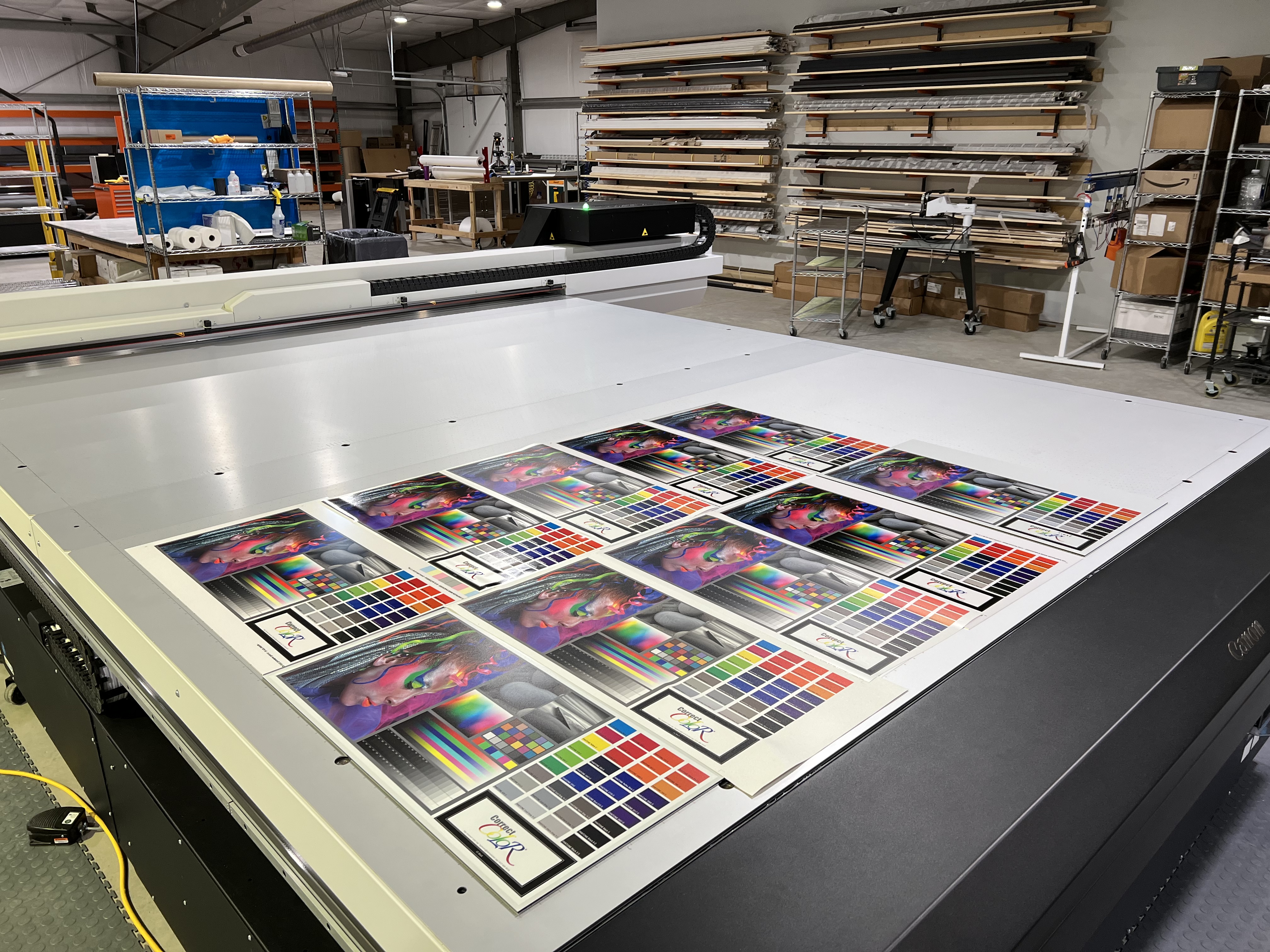

Ben, I know exactly what you mean. We fought with color shifts on ChromaLuxe with the Epson F7200, 6200 and 6370 printers since we started doing metal. It was constant problems with no help from UW or Epson. The biggest problems were the prints would cure way too yellow.
We switched rips a few times and ended up with ergosoft. To get rid of color cast we were editing dot gains after the profile was created which I hated. Customers were pleased but I knew our color management was flawed. We finally started doing black and white ramps once a week and putting in correction - a terrible idea.
We also had the greens in our black and white prints. This is a common issue with chromaluxe and I have seen it in prints from many labs, some that are known for their color accuracy. We especially had problems in areas of high detail that would have this weird bright green color.
We had some ink problems once but I think that was just a bad batch or maybe distributor put it in a hot place or something. We replaced all four colors to be safe and moved on.
When we purchased our Arizona and Colorado printers everything was printing ok but there were always slight differences in color from each machine. Not noticable unless you laid them side by side.
I’ve built my own profiles from the lightjet days. It was a hard pill to swallow but I decided enough and hired Mike Adams. I had seen chromaluxe prints from competitors that I knew he profiled and was impressed enough to take the plunge.
He came in a month ago and did 12 or 14 profiles over a span of three days. All our products now match in color and he got substantial quality improvements out of every printer. He obviously understands both color and cmyk print processing especially with light inksets. The Chromaluxe has never looked better and we have not seen the green cast in neutrals since - I’m keeping my fingers crossed.
