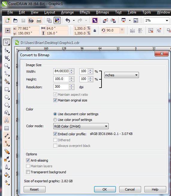

Lately when I try to export to tif corel X6 does all sorts of strange behavior. The size should be 84" x 126" but corel resizes it to 84" x 100" and I cant change it. I never had a problem with this until I "upgraded" to X6. Any idea what the problem is?

oof 84"x126" TIFF is a HUGE file...
I've been coming to realize that there is a 30000 pixel limit for bitmaps...
it will probably come out correct if you do it at 200 dpi
