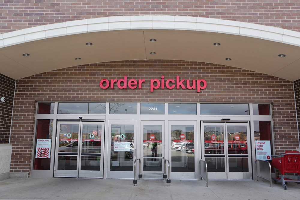

I happened to go to Target one day, in the middle of a renovation. I was amazed to see a crew of about 8 guys wrapping the front entrance frames around all the glass...
All that silver is wrapped....
