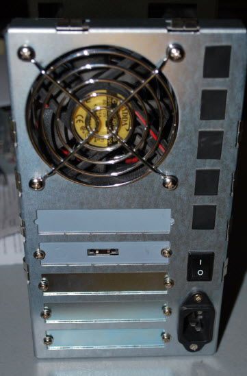

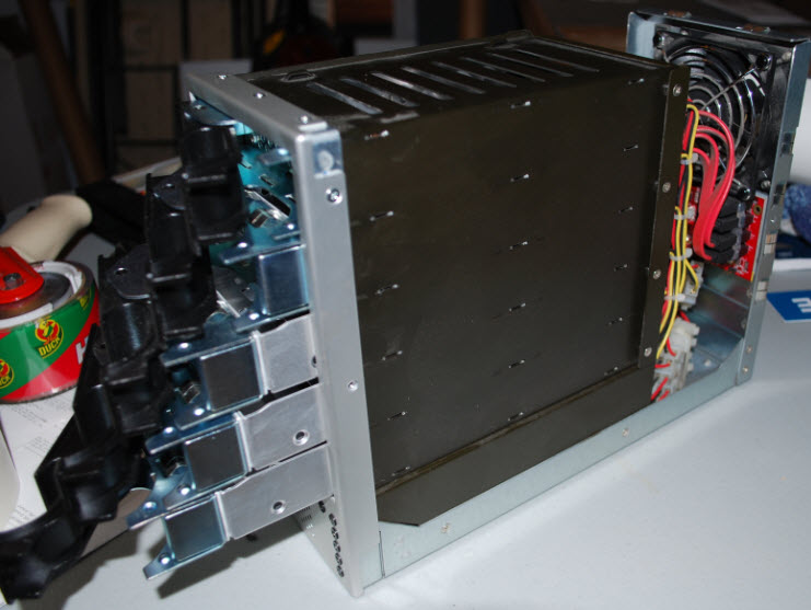

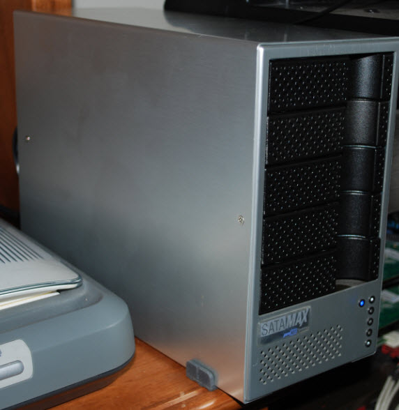

Any of you guys use big external drive arrays for backups/file storage?
I picked up two great 5-bay hot swapable eSata RAID enclosures. Seriously well made, all aluminum & steel. No plastic anywhere! Bought from a video editing company that went out of business.
They hold up to 5 2Tb HDDs (yep, thats 10TB !).
So, how would you configure the 5 drives?
- One giant JBOD, 10tb Volume??
- As an 8TB RAID 5?
- As a 6TB RAID 5 with a hot spare?
- As a 4TB RAID-10 with a hot spare?
- Just as external drive, no raid?
I guess I could use both enclosures (was going to sell one on CL/eBay) and create a 10TB Raid-10
How long do you think a 10tb Raid rebuild would take! ? <GASP>

there is nowhere to add a fan, the one in there seems to be good, ProMAX use the best parts they could. I have 5 drives in it now, all between 91°F and 96°F
round man
I would suggest a raid 10 with four of the drives. that gives you the options of mirroring and striping for best performance and redundancy for security.
