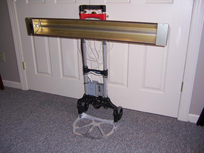

i made my own on the cheap. mail ordered a quartz heater. hooked up a timer dial and a router control to moderate the heat output. less than 250$, but it's not exactly "UL listed" either.
