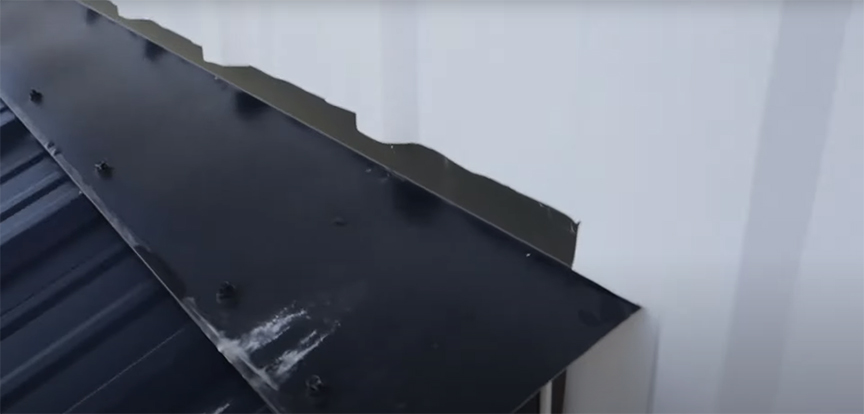

With that large of a gap, you'll need to use some flashing and make it large enough so you can cut the grooves out in the back. Then caulk it.

Also, I seriously doubt you will be able to create an effective barrier at the top of the awning. Theoretically, you could use a short section of the same corrugated roof panel to contrive a flashing piece to overlap the awning top, but it seems impractical, and will probably leak in a short time.

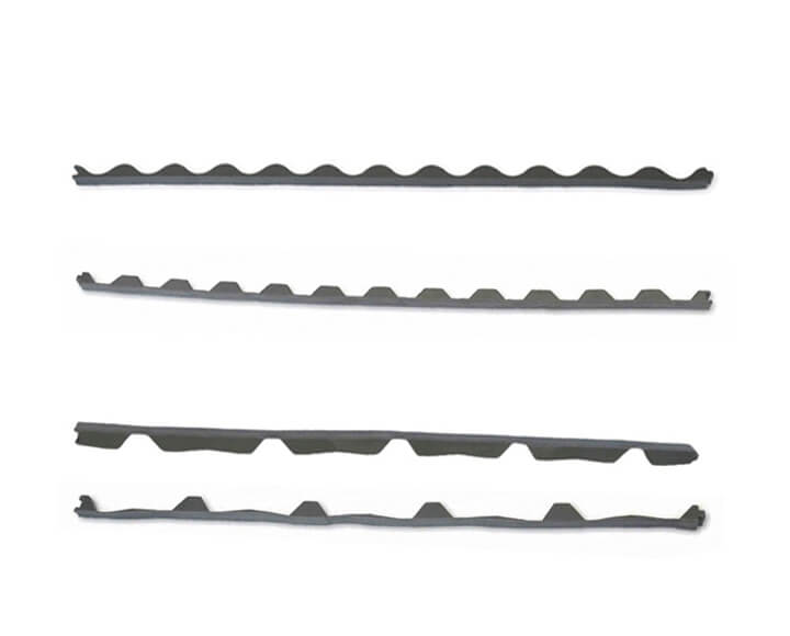

You could try foam sealing strips between the upper support and the siding. They're available for most standard profiles/ brands of steel siding & roofing, mainly used for sealing ridge caps. They're sealed in place with a butyl caulk or butyl adhesive strips. They look like this... Something to think about.
