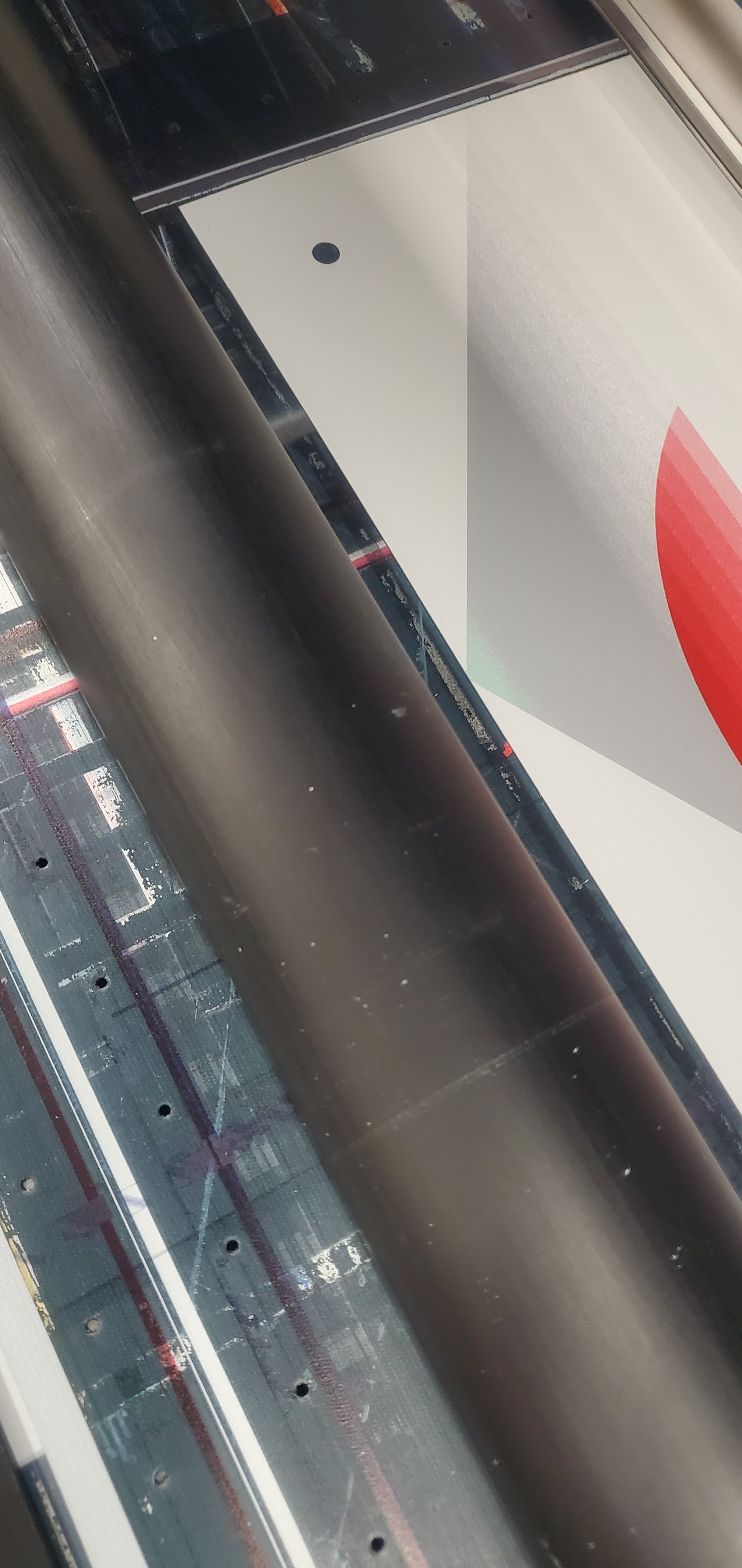

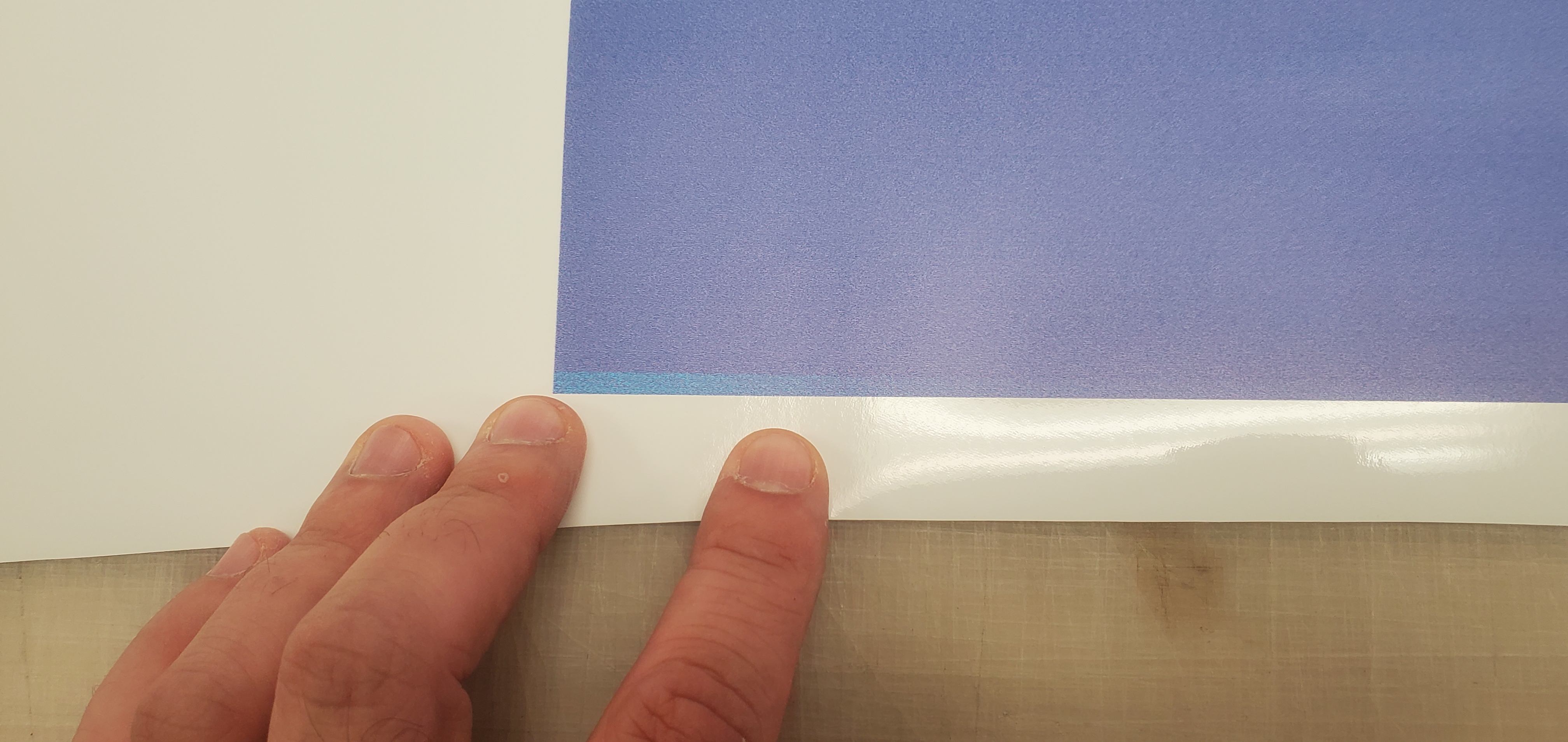

I've been having this issue off and on for a couple years now. The leading edge starts a print with a faded streak. It only happens on that first 1/4" of print. We've had ink and printheads replaced since it started, but can't figure out what causes this. I've attached examples. 20220103_144437.jpg 20211215_154145.jpg

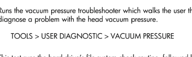

You should adjust the vacuum pump. There is an adjustment screw, accessible at the back of the machine, where the ink cartridges are located.
There is a suggested range for the value which is shown on the display when entering the vacuum pump adjustment menu. Unfortunately I dont remember where to find it because it is long ago that I have adjusted a FB myself.
