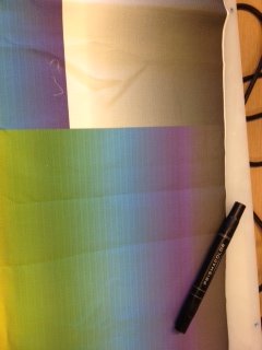

Also here is an image that shows a print out with a black marker to show a rich black. Everything seems to be a dull.
It seems to me that it is more the ink is just being absorbed by the canvas. Is there special ink you need for canvas printing?

Is it just me or am I seeing some nozzles out? It looks like there are some white lines in the passes, either missing nozzles or your media comp is off.
What profile are you using? Is it appropriate for canvas?

The color profile is: ADOBE RGB (1998)
There are some white lines in that print but we fixed that up.
