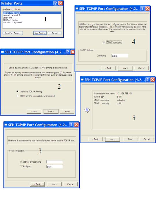

Okay... Just set up a HPGL plotter targeted at that address... It at least printed something. Now, before I get through with this message...
Went back and switched production mangler from looking for a TCIP port to looking at the specific thing I just created.
SUCCESS! Or at least somewhat - I don't know how buggy things may be...
Bogie
Here's what I did...
And thanks a bunch, guys... Y'all got me thinking in a different direction. Still may just direct connect via parallel... The SEH seems to go offline after about 5 minutes... Yeah, I know... It's probably some setting somewhere...
