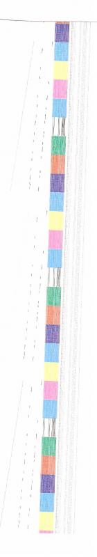

This problem may be similar to one in another post, but I will ask it anyway. I have a Falcon Outdoor Jr that I purchased new two years ago but have not put into service until last month. The black ink has given me nothing but problems from day one. When I do a nozzle check in the morning, the colors are fine, but the black never prints good. I do a cleaning and it helps, but it seems I have to print about a 6 inch picture to get the black to print good. Then the nozzle check is fine and it prints fine until I let it set for a couple hours, then it is back to the same as it was to start, like the black is clogged. I checked the dampers and the black one is completely full even before the first nozzle check that is attached. Since there is ink there, I think that tells me that the problem is either damper, head, or capping station not sealing well. Sometimes if i put in a new cartidge, it helps for a day or two, then it is back to giving problems. I tried to include a nozzle check scan that was done this morning. Anyone got any ideas?

zgraphics
I had the same problem... The tech use a syringe and alcohol to unclog the dried ink in the line. and it worked great now my problem is printing excellent. Good luck

I think it might be time for a new black printhead. I don't think it's the capping station, if it was it wouldn't pull any black ink at all I believe. The falcon uses the Epson printhead the same one as the epson 3000 printer. You can get it for under $100 . Go look up compassmicro.com

thanks to all who have offered advice. i used cleaning cartidges and refilled the ink and it seemed to work pretty good. but tonight i printed a piece which went perfect, then about 30 minutes later, my problem seemed to return on the next print. the black acts like it is almost out of ink, but there is ink in the damper. three consecutive test prints show three different print patterns for black, it is never the same nozzles not firing. one that fired before is not now and one that did not before is now. also when you try to print something with black, until it prints for about 6 inches, the black kinda oversprays and is not sharp. it actually looks like the black is banding from low heat, but i think that is the nozzles not all firing correctly that the test shows. another thing i have noticed is that the problem seems to occur more frequently if the machine does an automatic clean prior to printing. may be a coincidence, i dunno. i am kinda getting disgusted over this!!!:banghead: any additional advice is appreciated
