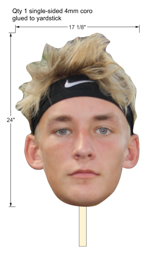

max 24"h x scale. 4mm coro, vertical flutes. Yard sticks from Lowes cut in half then glued to the back.

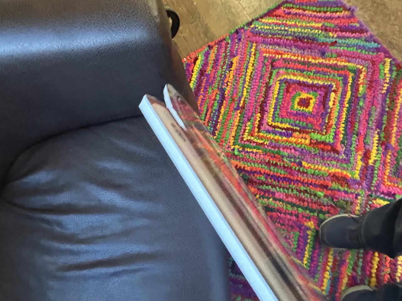

This is what I do...I'm guessing everyone does it pretty similarly.
-Make sure image looks good at 100% in the computer. If not, I run it through Topaz.
-Crop image close to the trim line. I don't bother taking much else off since it's getting hand cut my brain is the trim line.
-Print, laminate, apply to foam board or the like

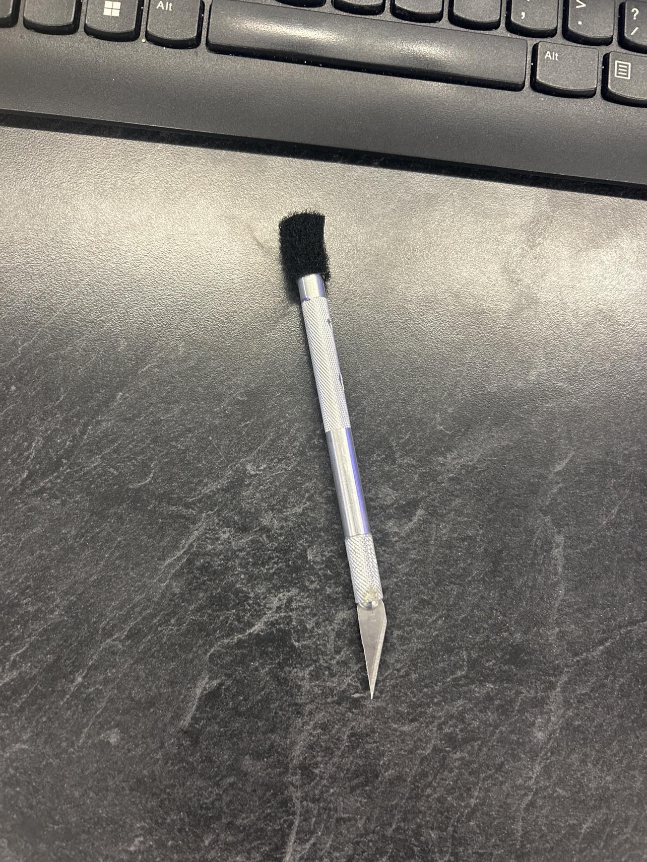

-Trim with a blade. I like the below blades because they get around corners pretty well. I usually trim with a slight angle going towards the back as shown.

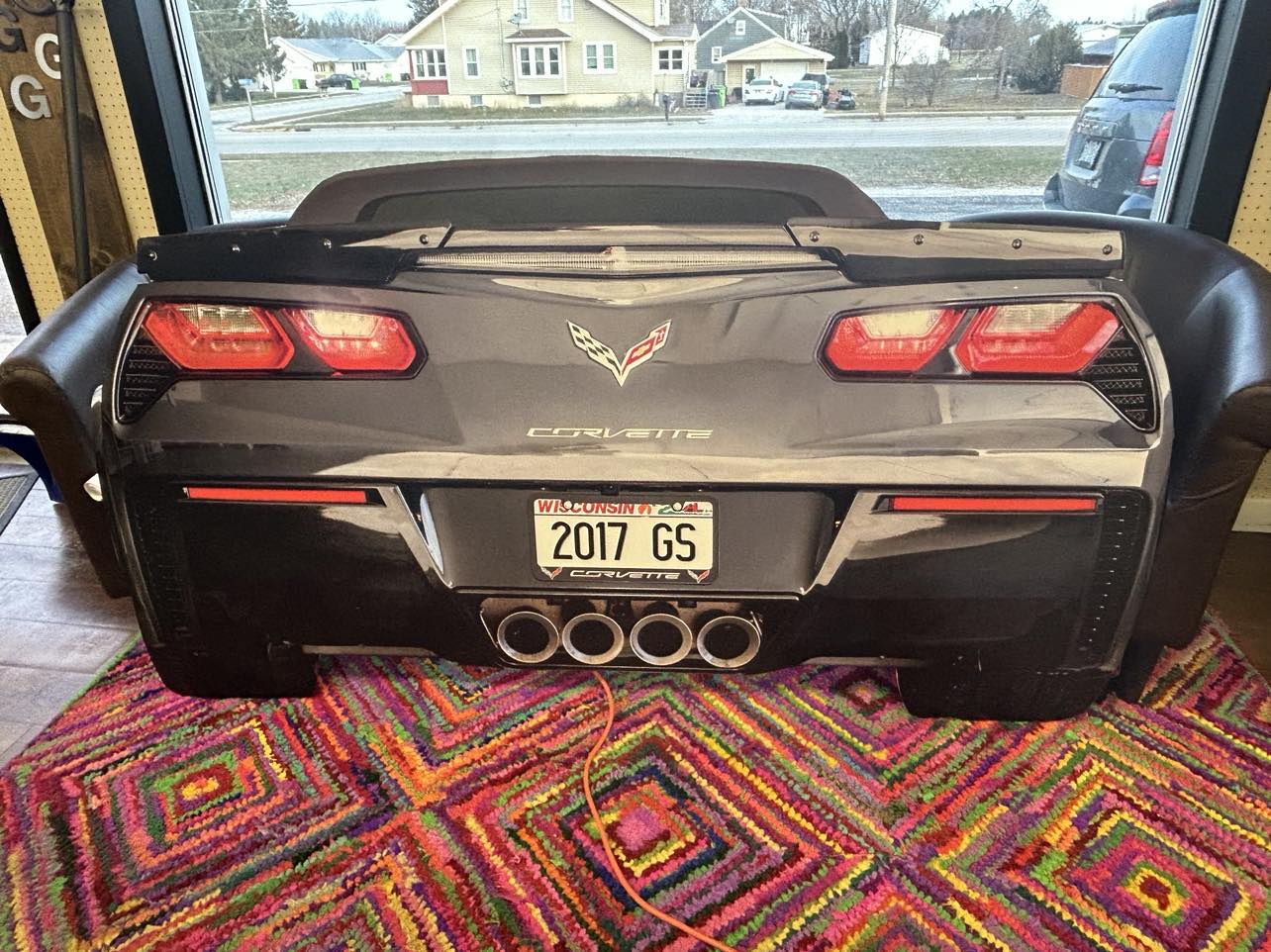

-I just did this corvette yesterday. I printed it as a rectangle.
Boudica
A utility knife. Use a fresh sharp blade.
I print a "cut path" a very faint line as a guide to cut along. First I cut it down to a square or rectangle, then cut along the fine line.
Boudica
Stacey and I were typing at the same time... +1 for cutting at a slight angle, I was starting to explain that but it was getting too wordy, and I'm on my phone.
