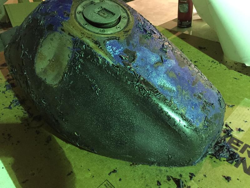

Hey all,
just wondering what your favorite vinyl is to use for wraps. I've been out of the industry for years and am now doing installs for a company here in Louisville (premier fleet graphics) and we use 3m 1080 for a lot but I'm wanting to possibly try something else for my motorcycle tank and want to try it in once piece (we'll see how that works out after a few attempts ;) ). Color I'm looking for is 3m's satin canyon copper but I have some matte army green to use to practice or keep if it looks hot)
joelswork
That's the "during 6 layers of previous owners painting attempts" picture. Dents are now fixed and it's ready to prime and paint this weekend

joelswork
Well, for the filler applied, sanded and the primer on and sanded today as well. First coat of paint was going to be tonight but I bought flat black and am a bit concerned about wrapping over flat and how long out gassing takes. After talking it over with the install manager, he's pretty sure it's easy enough to go at it with no special technique needed... There are a couple indents that concern me though. Classes tomorrow through Thursday night so I'll probably try wrapping on Friday.
