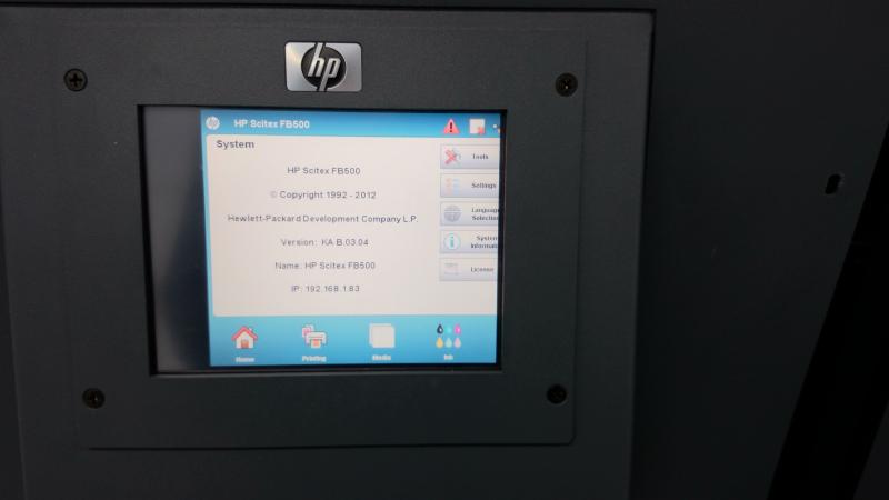

Has anyone come across this? I turned on the machine this morning and the image has shifted 20mm to the right. The screen still functions fine, I just have to click where the icon 'should' be, rather than where it displays.
I've tried restarting numerous times, updated the firmware, pulled off the cover and checked all connections.
Any thoughts?

first time use other Videocable to check it now.
2nd step use a other Display(normal TFT) connect it and see same trouble so your error comes from IO-Board or the OEM tocuchscreen.
