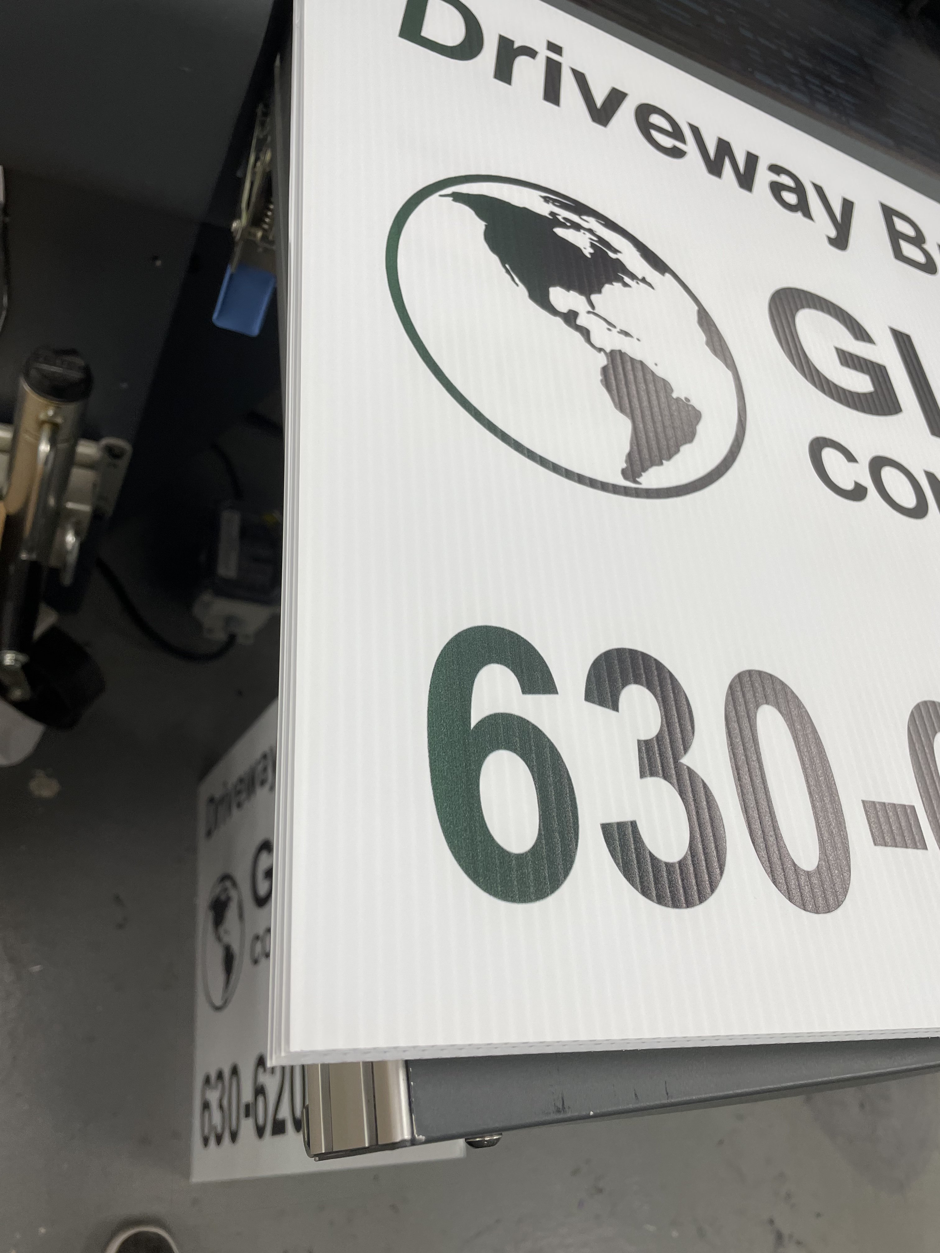

Sometimes my prints fade out at the end of the print, happens randomly usually..anyone know what I can do to fix?

I haven't and I do tell it the size, it'll print the whole thing it's just that sometimes it doesn't print all colors so it's faded the first inch or two, and then the next print is always fine afterwards
