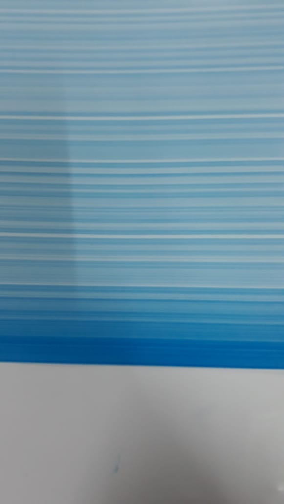

Now I manage to fill the head with ink and the problem was the big filter after the pump, although I change it when I change the new ink box but I think it is has a factory fault .but now I'm still have an empty color after start printing , I attached a photo for whats is the problem.
Many thanks for your help
