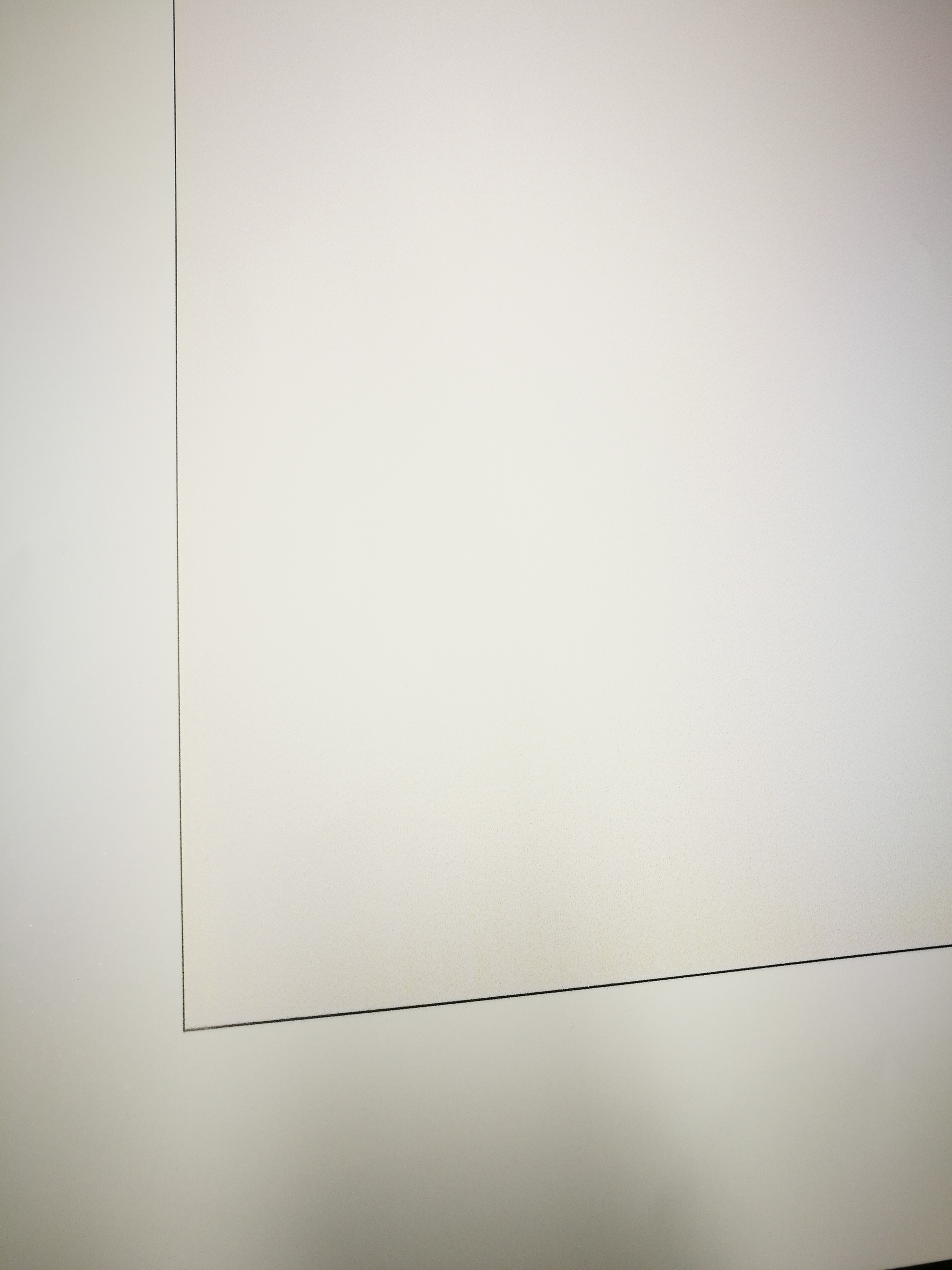

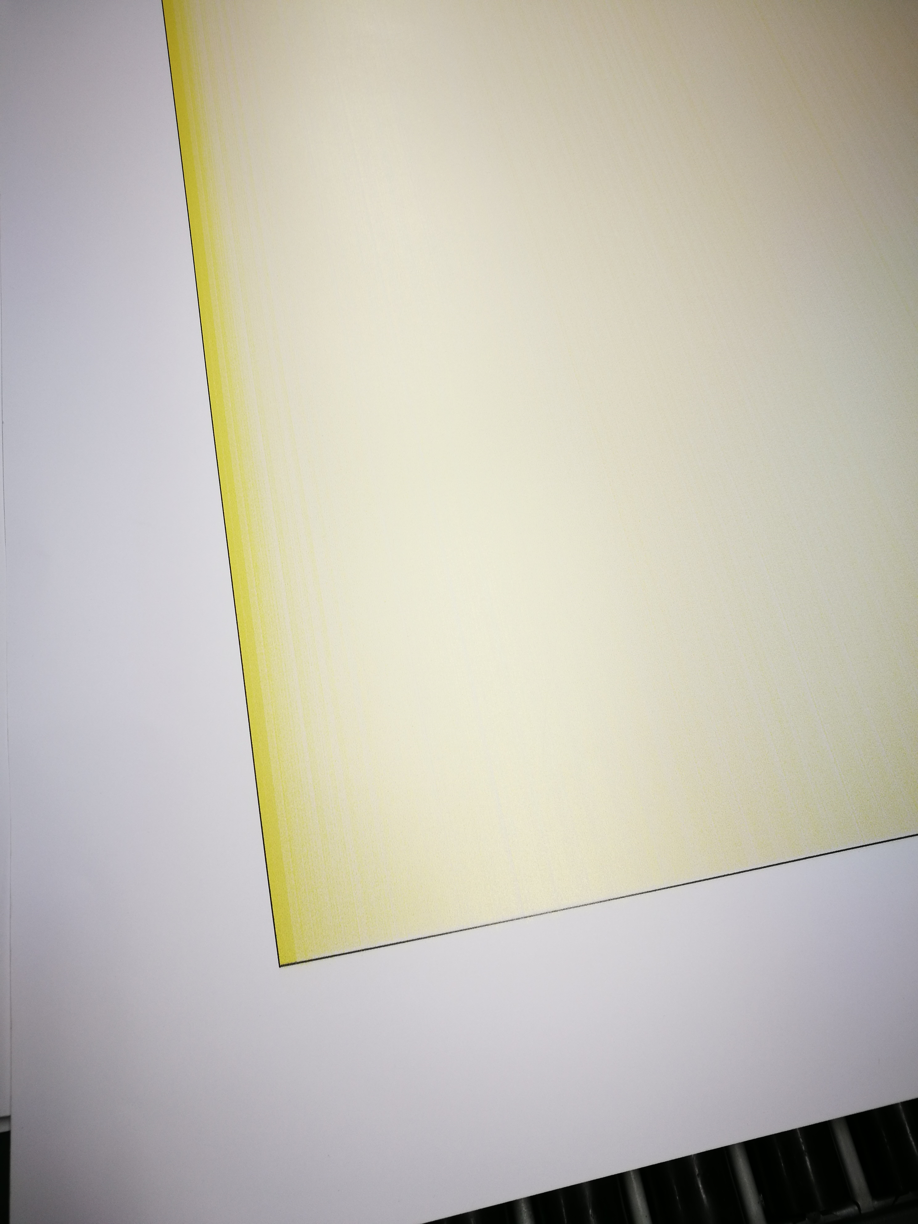

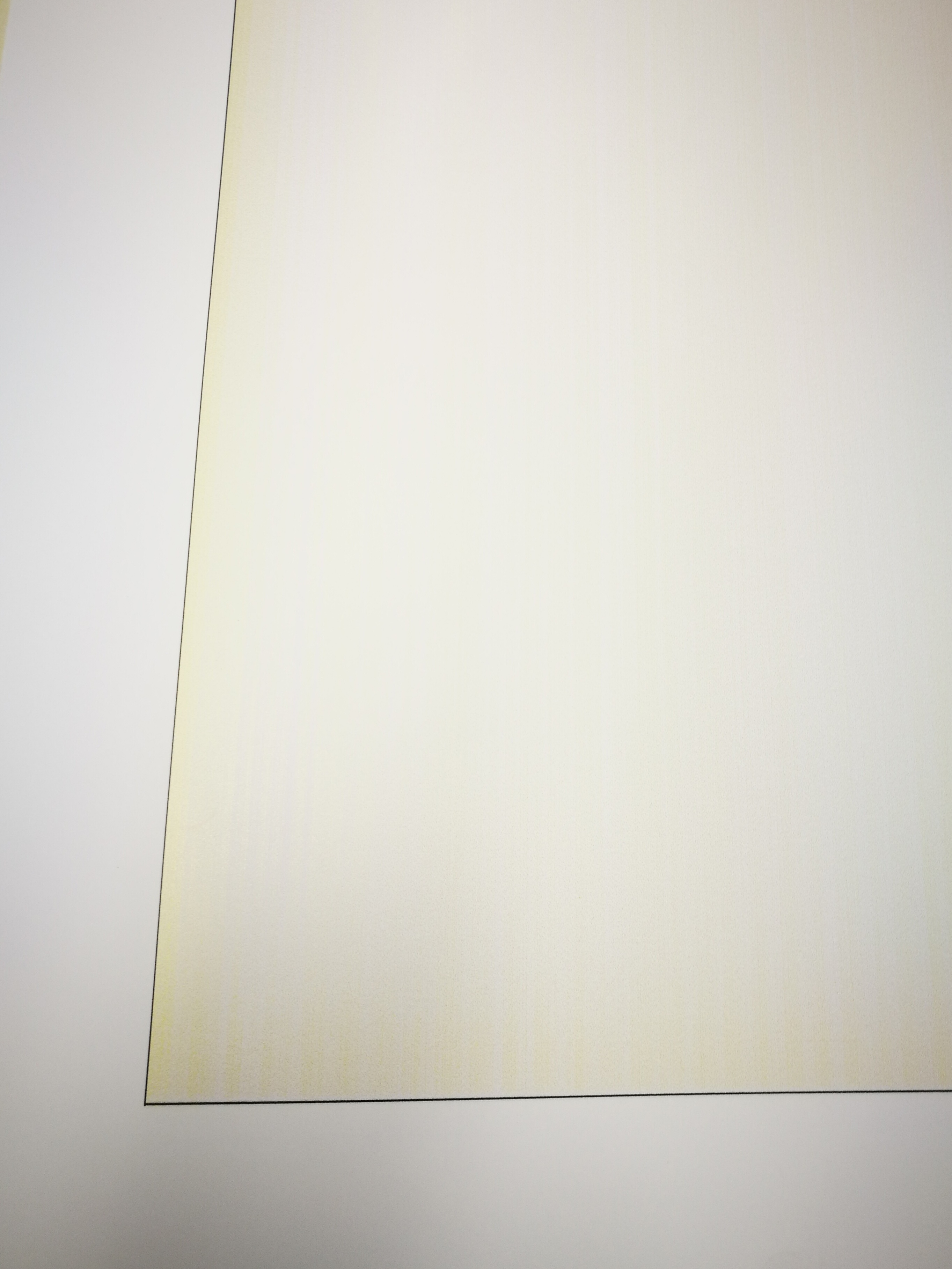

Have a problem with a HP Scitex FB700 that we can't figure out.
When you start to print it doesn't print yellow, but yellow slowly builds up so after about 3 meters it prints yellow as it should. It's like a gradient from transparent to yellow. When it finally prints yellow, it prints yellow as it should - if you print continually. If we let it rest for a while we have to start the process over again to get any yellow at all.
We print sheets in size 70x100 cm for test. First sheet: no yellow at all. Seccond sheet: start seeing yellow, especially around the edges. Third sheet: yet more yellow, still stronger around egdes. And so on. (See attached images)

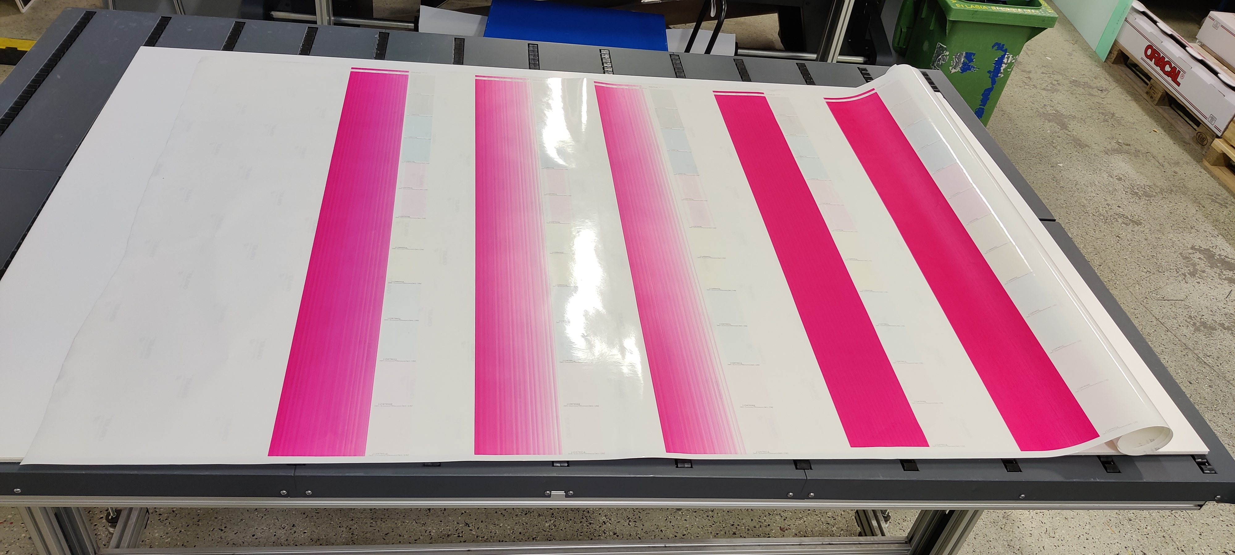

Problem is the ink. HP ink for FB700 printer is very pad quality. We have had same problem with black, magenta and yellow. We order new ink box, drain old ink out and fill new ink in. Our suplier gives us the new ink box free (if old one is pad), but all this takes time and we cant use printer with pad ink...
And we have had this problem over a year now. Its every time pad ink, not once hardware problem.

This is what we get with HP ink, 3 left prints are result of bad ink, 2 right prints are from new ink box (heads drained and filled with new ink). And this is sometimes with Black and Yellow too. I'm interested where to find reliable ink?
