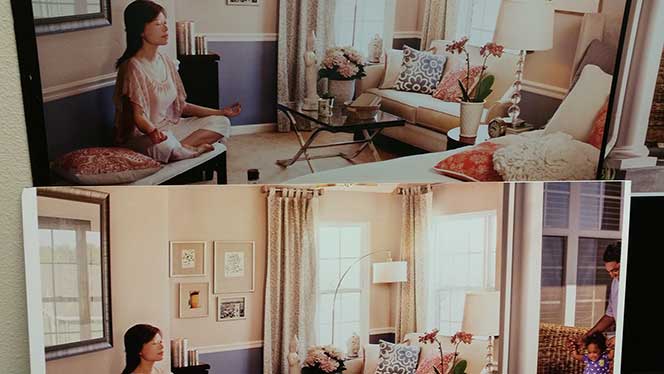

Even at the highest quality (Max DPI - which we had never used for anything prior to this test), the images come out dull compared to both the displays my customer already has and compared to my own print on white material. It just seems that the white underflood isn't opaque enough to give us a rich color on top. I've included a photograph below - the top image is printed on black PVC, the bottom image is printed on white.
We're running the newest version of Onyx. Is there just a setting I'm missing, or does white just not work like we expected? My only other thought is that I could print white across the entire 4' x 8' sheet of material, and then print the graphics with a white underflood. However that's not time or cost efficient.

UV white is not very strong.
If you want to cover dark color with uv white your are going to have to print 300-400% white. My flatbed lets me print 400% or more in the same pass, not sure if the fb700 lets you.
i don't think the black PVC idea is a very good one for a print with that much white.
danno
On our FB700 I have found that when the job is in ONYX, I can select the Color Correction tab and adjust my white. I will usually run +75 or higher.

Not sure, but check if there is a way to double print that would allow you to put more white. Scitex is an older technology, that could be a limitation. On the StratoJet Printer I have you can layer upto x16 in single pass almost around 500-600% depending on pass mode selected, and keep white at 100% for complete solid white. Check with Hp if there is a way to increase the white percentage, or double up the passes..

We were never impressed with the white ink on our FB... So glad they invented Zebra board! If it was a small project I would skin the sheet with an opaque white vinyl (matte), For a large project, find a supplier of W/B/B sintra. We get cases of W/B/B ultraboard.
