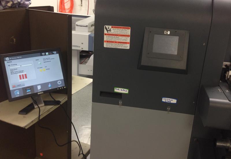

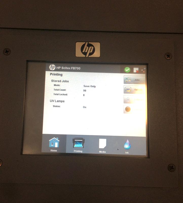

Has anyone else had a problem with the touchscreen displaying wrong? When I turned on the 700 yesterday after being shut down over the weekend, the display comes up and is about an inch off to the right. I've checked and made sure all my cables were connected and tight, swapped out the VGA cable and ruled that out as the culprit. Re-calibrated the screen according to the service manual. And it's just the image that is off, you still have to touch the screen where the buttons would be if it was displaying properly.
I can hook up an external monitor to the 700, and it displays fine with no problems, other than it's just a cheap dell monitor and I still have to use the touch screen to input anything, it's been an interesting day to say the least, but better than being dead in the water
Any information would be helpful... trying to try all avenues before having to replace it and hope that solves the problem.
hopefully the photo comes through...
Displaying wrong
What we're working off of right now just to keep up with jobs... still have to use the touch screen to do anything but at least you can see the entire screen.

We had to order a new screen... in the mean time used an external monitor and then using the touch screen for input. It's interesting to say the least but at least we weren't completely dead in the water.
I did try to be sneaky and hook up another touchscreen monitor that we had around, but that didn't work and I really didn't want to explain to the boss that I wrecked the printer because I was trying to make the other monitor work. I take enough stuff apart as it is ^_^
