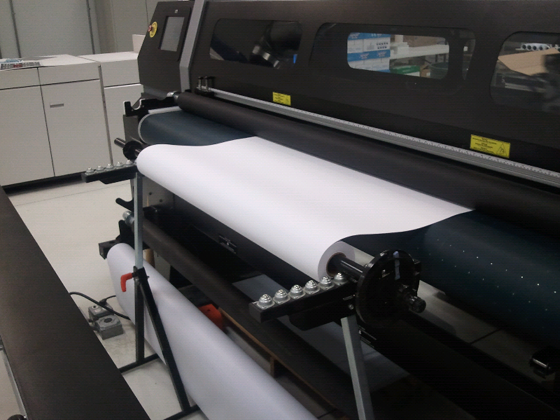

I've got a large order for 102" signs that we are running on Sihl 3333 paper. Now the 950 usually walks a little on roll feed media but this stuff can barely make it through a couple prints before it's climbing off the edge. The print is 35" wide, we had to go to the 42" paper size and it's still only able to go 3-4 prints before I have to stop it and reload the media. Anybody else run into this? Any tips? The 950 has been a huge step up for us and have been very satisfied with it but this little glitch is slowing this tightly scheduled job down. I am assuming the main issue is with this particular paper.

We see some skewing, but it's usually not too bad. One of the biggest areas of improvement for this machine is the roll feed system. The foam rollers are a joke, and the thin pole they use flexes without much weight.
We've had luck just setting the roll directly onto the infeed table and feeding the media through the machine.

Hmmm, may have to give that a try. I've quit using the first roller. It seems to run better going straight to the belt instead of over that first foam roller. Of course, this morning when I came in, all but cyan had dropped out. Still not sure how many it ruined...
kev324
So far I'm having the best luck running it this way. Kinda redneck looking but it works..
Not using the takeup seems to help but what a PITA

A little update, I ran out of the 42" stock and had to put on a 36" to finish the last 12 or so prints. Feeding like we have been, its feeding almost perfect. Even better than the 42". ...scratches head....
