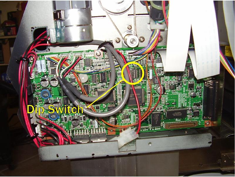

I don’t believe the level you are looking for can be achieved through the control panel.
To reset mine to factory defaults;
Turn unit off
Pull right cover off
Turn Dip Switches 2,4, and 8 on.
Power up unit
Select what mode you want.
Power down
Return dip switches to original selection.
Note, mine is a Sign Warehouse FC7000 and as I understand it the firmware might be different.

Matt Cuellar
Bradster,
Thanks for the info. I was able to reset back to defaults a few months ago without having to take off any panels, but I can't remember how. However, I'm pretty desperate so I'm going to give this a shot. Thanks for your help! I'll let you know how it goes.

Bradster941
1. Turn the machine off
2. Hold the up button
3. While holding turn the machine on and it will reset.
Hope this works for you
Thanks
Todd Castle
Todd, your right, but also your wrong as I understand it.
Your method is good for erasing certain user inputed parameters, but it doesn't reset all to the factory defaults.
My way is like flashing the Eprom back to when it rolled off the assembly line and was first programed..
