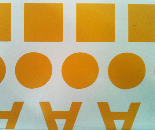

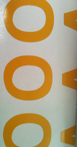

I'm stumped. Our FC8000's cut quality is not what it has been. We replaced the blade and the cutting strip but I'm still getting poor quality. For example when you do the force test (the triangle test) the triangles are not straight edged, they have a bit of a wave to them. I've tried going up and down with the offset and that's not fixing it. I've been using this thing since they first came out and never had problems with it. Any suggestions would be appreciated. Oh the media is standard FDC calendered colored vinyl
can you post a picture? Look at the tip of the blade does it look sharp, not chipped? Is your blade depth out too much? is your cutting strip down and tight? What offset are you running?
Ok, the blade height is fine, it's not sticking out too far. I've got my offset zeroed out. I tried going from 0 to +3 and to -3 and it never gets better either way. 0 is the best so far. No chips in the blade and it looks sharp but i'm trying to think how long that new blade has been sitting in the case (could be 3 years) I don't blow through blades that fast
