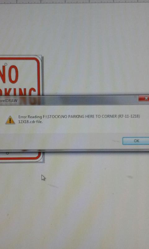

Hey. I am running Corel X4 and just purchased the Graphtec fc8600. I am having issues with cutting master 3. I get the message cannot connect to Corel. I have uninstalled Cutting Master 3 and Corel x4 and reinstalled. I am still having issues. Any help would be appreciated. Also when I try to search for a file I get the message of the photo I have attached
