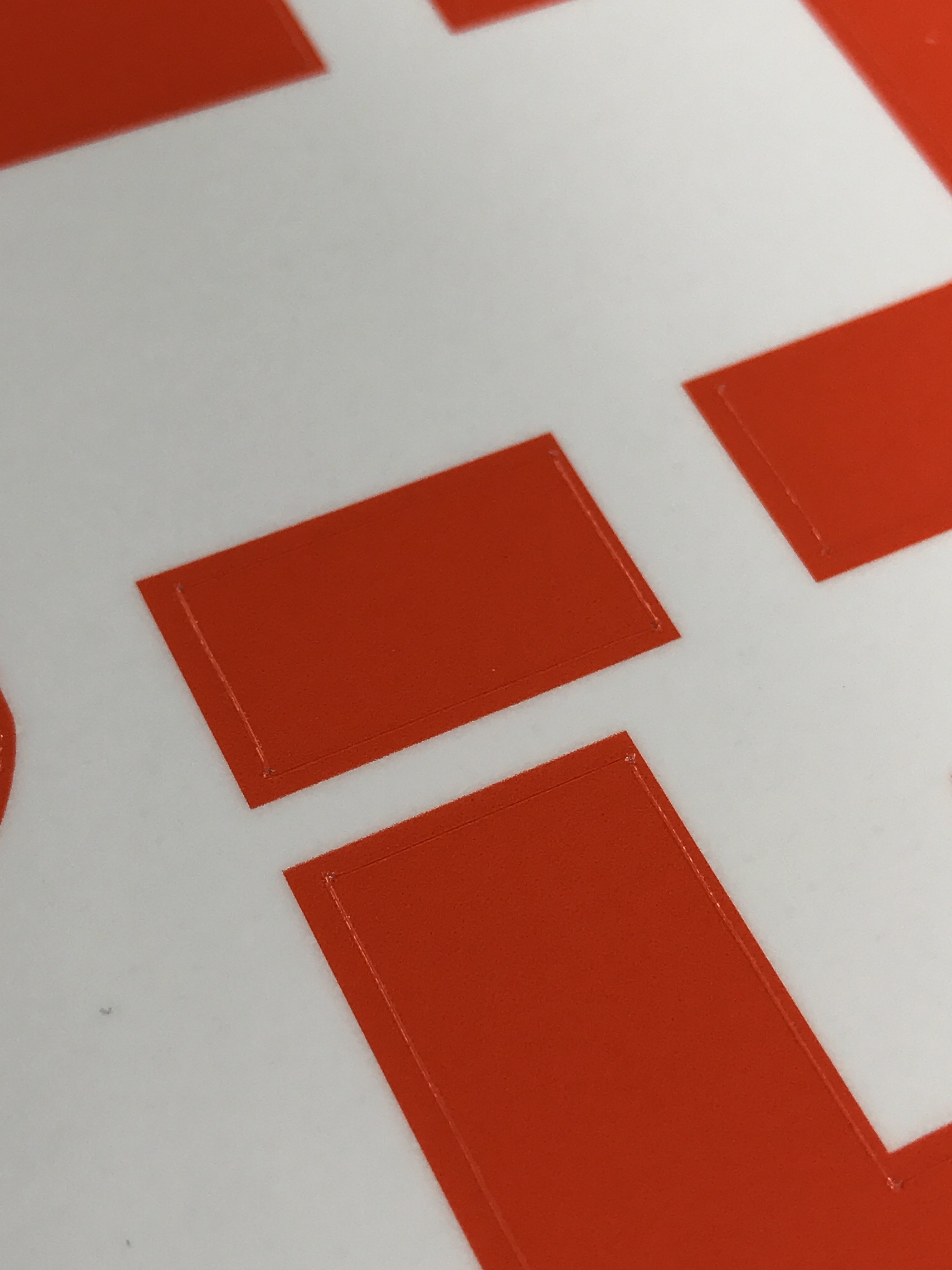

Doesnt matter what i cut, Oracal 3165, Avery 1105, 3m material sometimes oracal solid cut vinyl. The blade is set correctly. I also have an issue with edges of material. Like when i do a test cut for force the edges of the cuts are not neat and it always leaves a corner pulled. Ill add an image in a few.

image 1 is lifted edges or not clean corners.

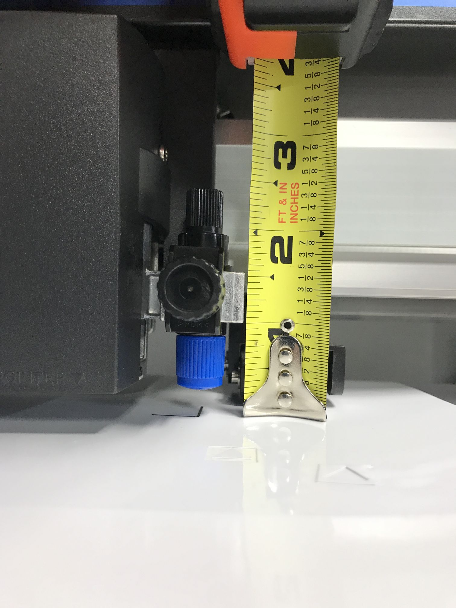

image 2 is the height when not in use.

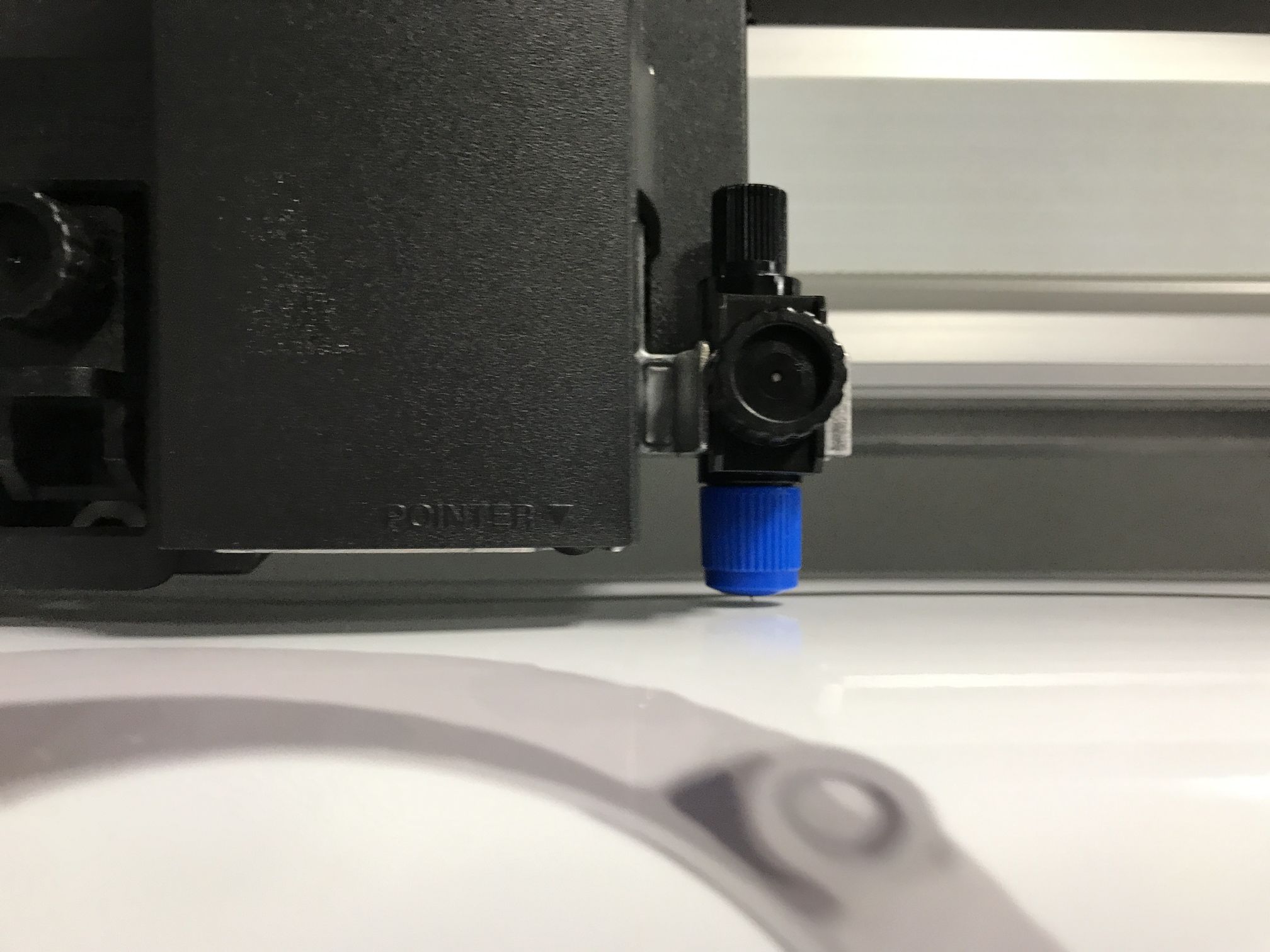

image 3 is height when it is registering or between cutting paths

Hit Menu>
TOOl>
Press down arrow twice
TOOL UP HEIGHT>
Change Value to 0.197
Thats as high as it will go.

ok update. If i load material into the cutter or a image with registration marks it is fine. The issue i have happens when lets say you change speed or force. It lowers the head very low to the material and leaves it there it doesn't raise back up to its high height.
Now if you hold the material and open the pinch rollers then close the rollers and press #4 to continue it keep the blade cutter holder hight high like it is supposed to be.
