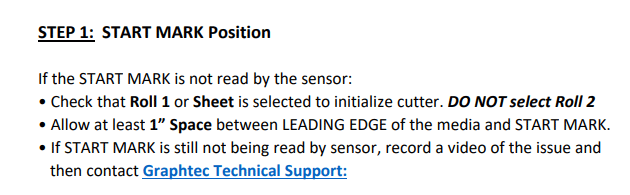

Silly question, I'm sure. I have read the bulletin "PRINT & CUT Issues and Solutions for the FC9000 Series". It is my understanding that the machine will NOT read a barcode if Roll Type 2 is selected as the media type, but that it WILL read barcodes with Roll Type 1 or Sheet selected. Is this correct?

Roll 1 brings the material back to the end and set zero point there. Roll 2 keeps the zero point where you filled in. If the head position is just before the barcode it should scan it, but if it is after, it won't go back to search it, because it is behind the zero point.

In the bulletin, it seems to say that you just can't use Roll 2.
Thanks Attila. I understand the difference between Roll 1 and Roll 2 and Sheet. I'm just verifying that I should still follow the instruction given in the tech bulletin to NOT use Roll 2. This is a screen shot from the bulletin:
