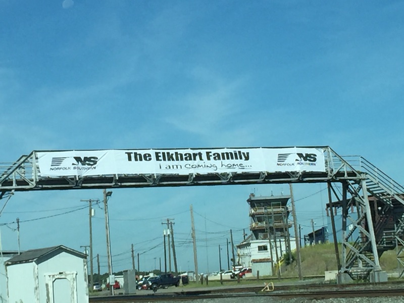

DirtyD
NGlantz - BeMesh - Printed (2) 60" x 65' on it and turned out great - they got attached at a train-yard on a walkover type of bridge
-Customer Install-
