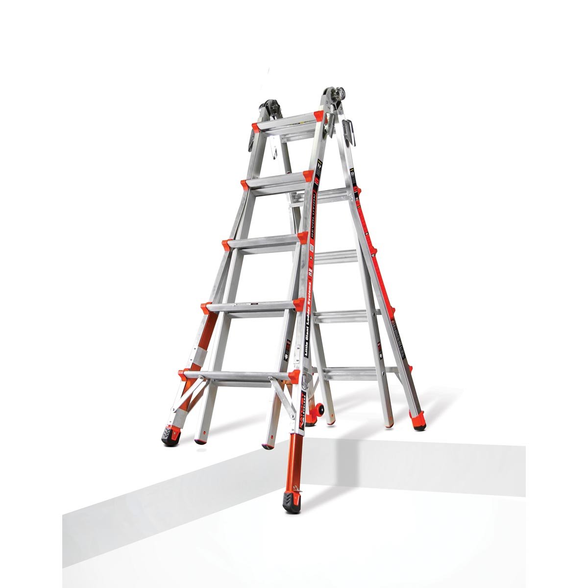

Just food for thought: virtually every commercial construction company bans any kind of metal ladder due to conductivity concerns. The metal "Little Giant Type" (multi-position) ladders are great but a fiberglass ladder would be needed on most construction sites.

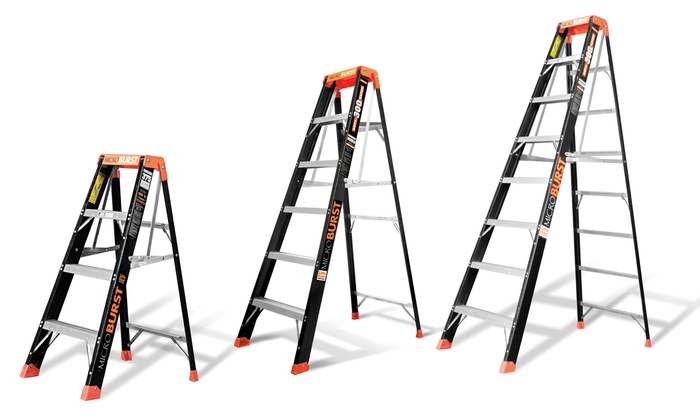

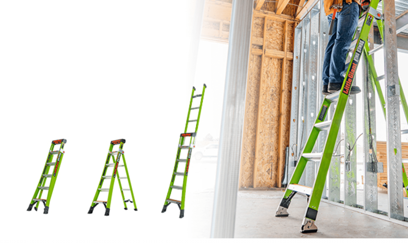

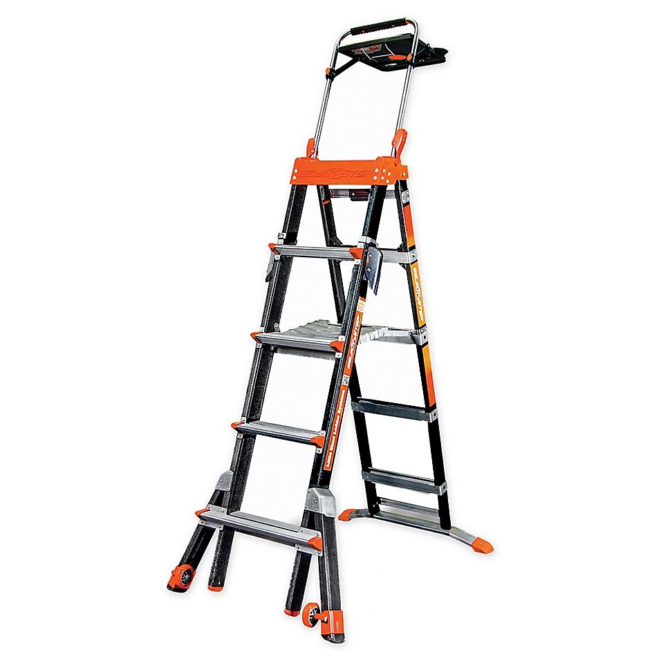

Little Giant makes some of the best ladders there are. I have the 8', 6' and 4' Microburst, the 6' King Kombo, the 6'-10' Select Step and the Xtreme 19' with ratchet levelers. They all serve unique purposes.

Not federal work, commercial construction. The builders themselves....Balfour Beatty, Turner, Austin, Beck, Archer, Reed...prohibit aluminum ladders during most phases of construction.

Is it because of insulation because aluminum ladders have pads on the feet, neither are rated as insulated as far as I know. I thought it has more to do with aluminum being more easily damaged and not being able to see it. You can't miss damage on a fiberglass ladder.

I believe conductivity is the primary reason but wouldn't doubt if the whole structural integrity aspect comes into play.
