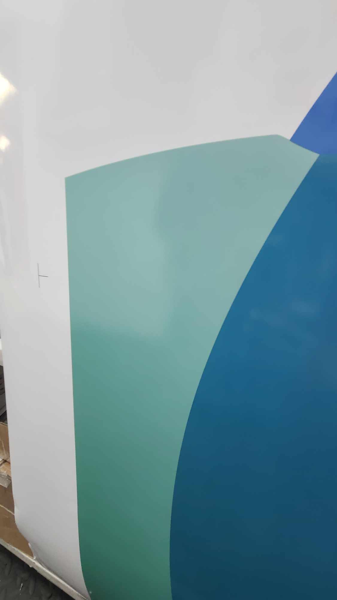

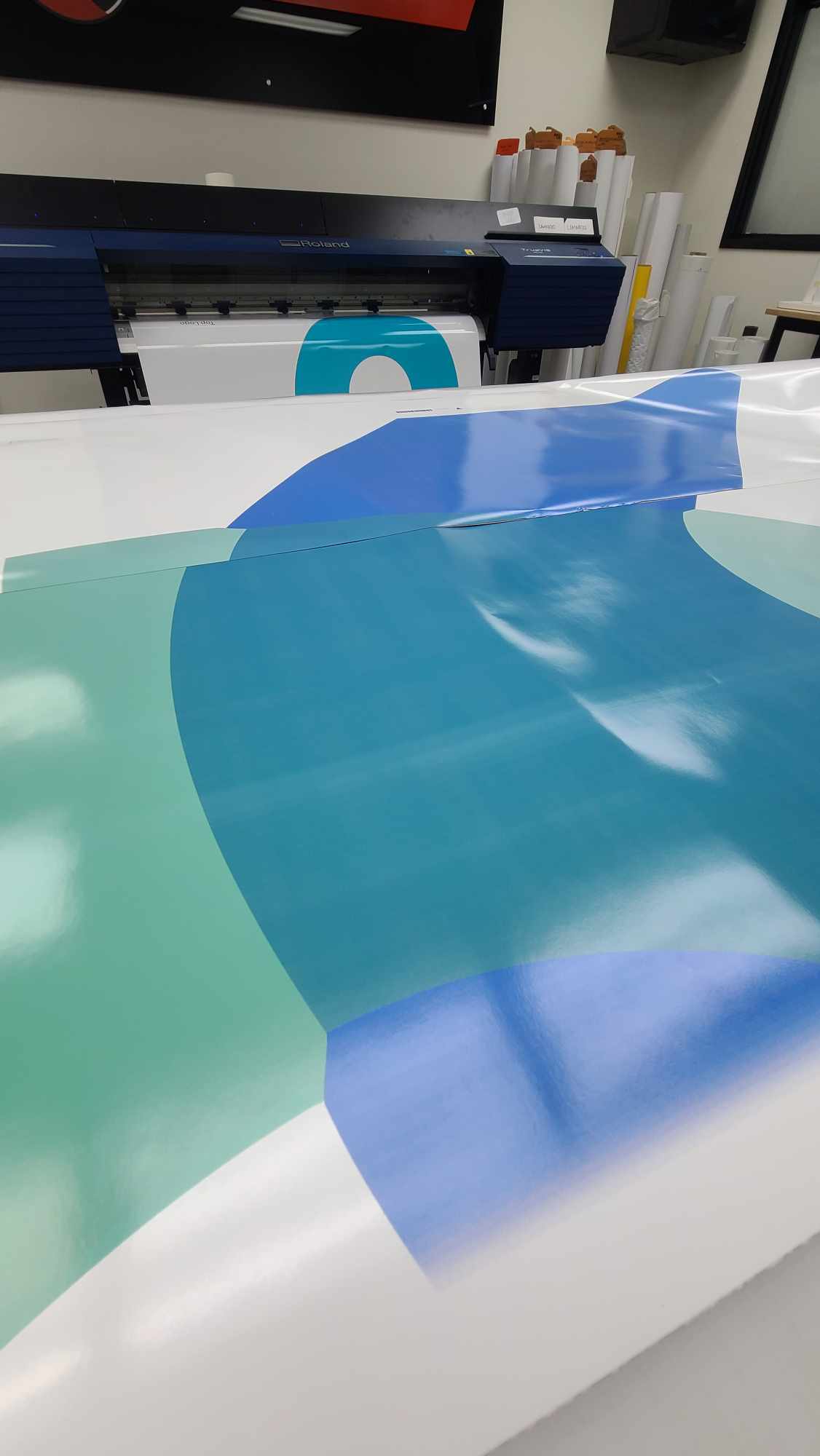

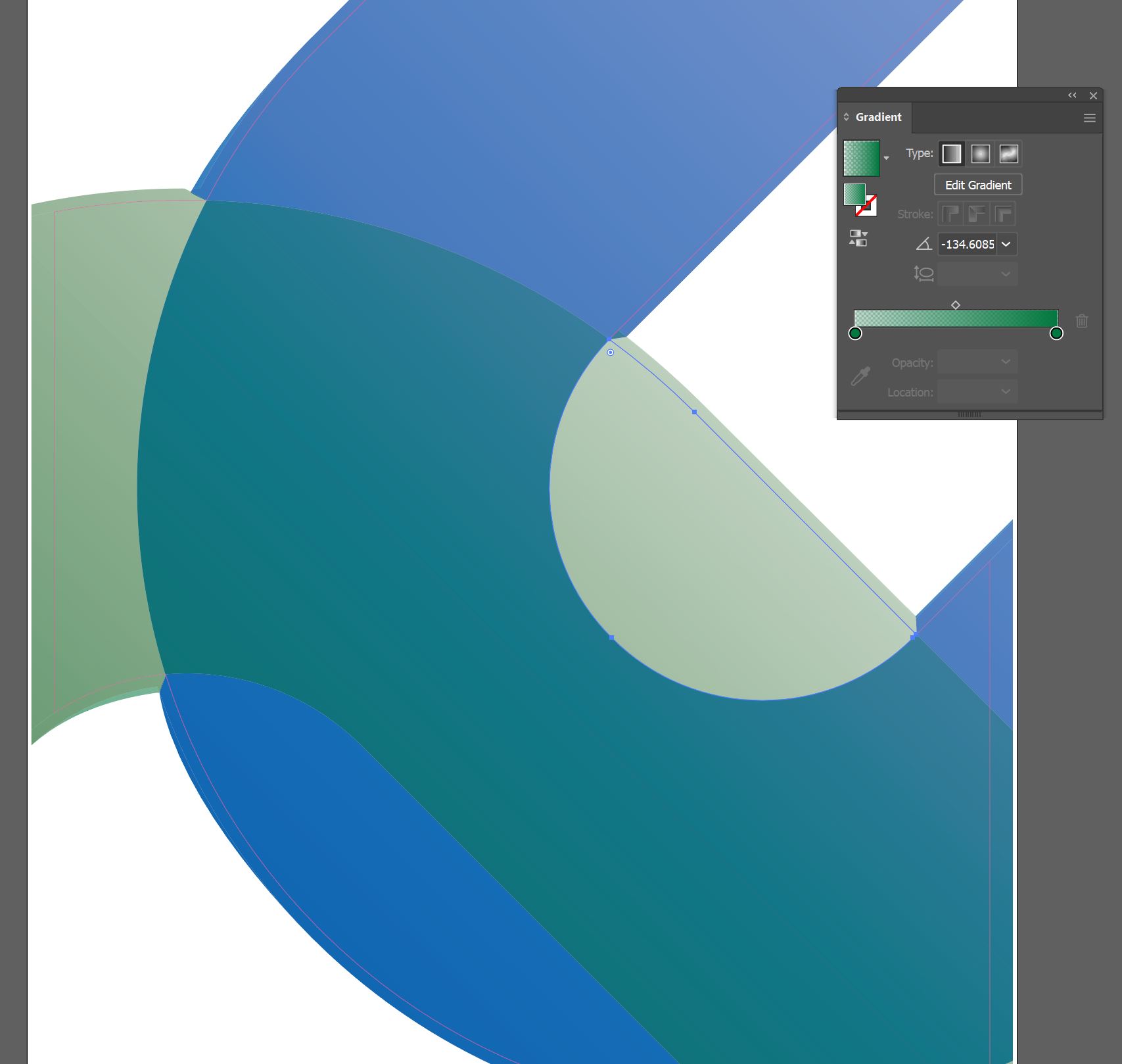

A customer supplied artwork with gradients that have Pantones. The gradient goes from a solid Pantone to a Pantone with 25% opacity. The issue is that there is some banding in the print. The file cannot be altered much as the client has already approved the proof. I have already tried to rasterize the vectors to see if this helps although the color will be a bit more off as there is originally Pantones.

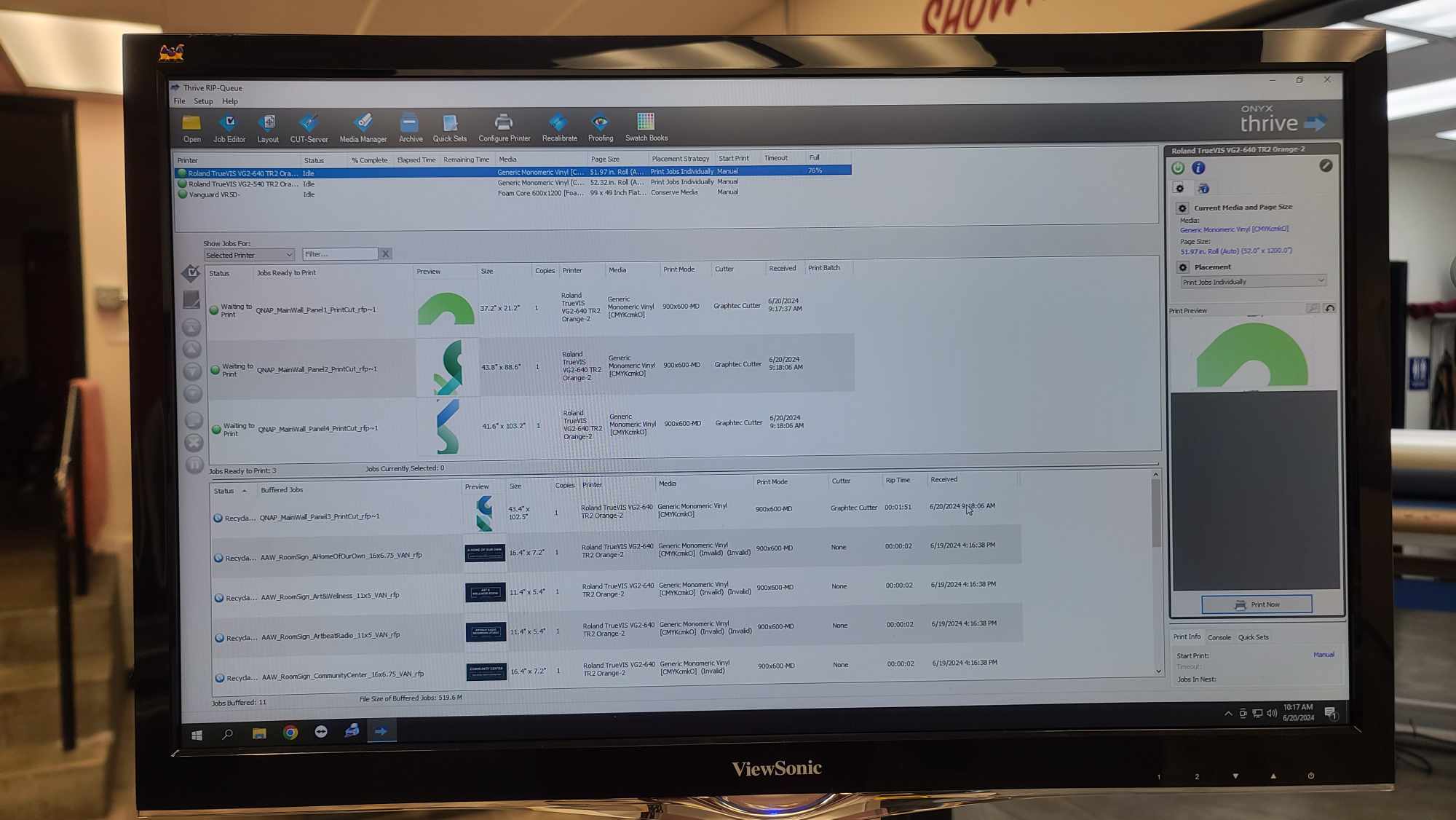

- Onyx Thrive

Try converting the Pantone spot color to whatever color space the file is in; RGB/CMYK. Pantones and gradients don't work well together a lot of the time, especially with transparencies.
BigNate
Make sure almost all, if not all, nozzles are firing, make a fresh calibration and then try again.... greys are tricky if the hardware is not perfect.

Use a higher print setting helps eliminate banding.
If not add photoshop noise filter will help eliminate some banding too.

Gradients, fades, opacity effects, color effects(multiply, etc), all I find rip and print better if they are rasterized first. I don't think the RIP software likes vectors changing their colors
victor bogdanov
Make sure when rasterized the file is 16 bit or 32 bit and that your RIP is set to 16 bit processing. Produces better gradients than 8 bit.
rvolkers
i would try 2 things!
1. save a pdf and then try to print again
2. Open it up in photo shop and save as a hi res tiff - start with 300!
also double check your color settings in the document - even if it is pms make sure (spot Color) is selected and also try cymk rather than spot?
