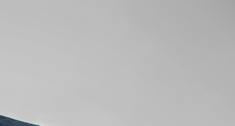

Here is an example after applying a lens vignette in 8bit RGB.
I go into 16bit mode, apply the same filter, and banding is hardly there... tried what you said - "flattened" it and went back into 8bit... wasn't there as much. But yeah the Linear light "magic grey layer" of 1% / 19% really works as bizarre as that read was!
