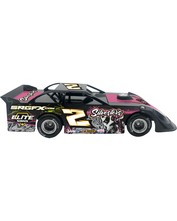

Right now im trying to find someone who can print in fine detail. Like font 1,2,ect
I am doing 1:32 scale race cars. Have a bunch of orders, but everything ive tried comes out too fuzzy.
Any suggestions? Attached is a pic of what other guys prints look like.

Use the highest resolution color profile you have available, slow the motor speed down to the slowest speed (usually a setting in the rip), and make sure your head alignments are perfect. Or have procolorgraphics do it.
