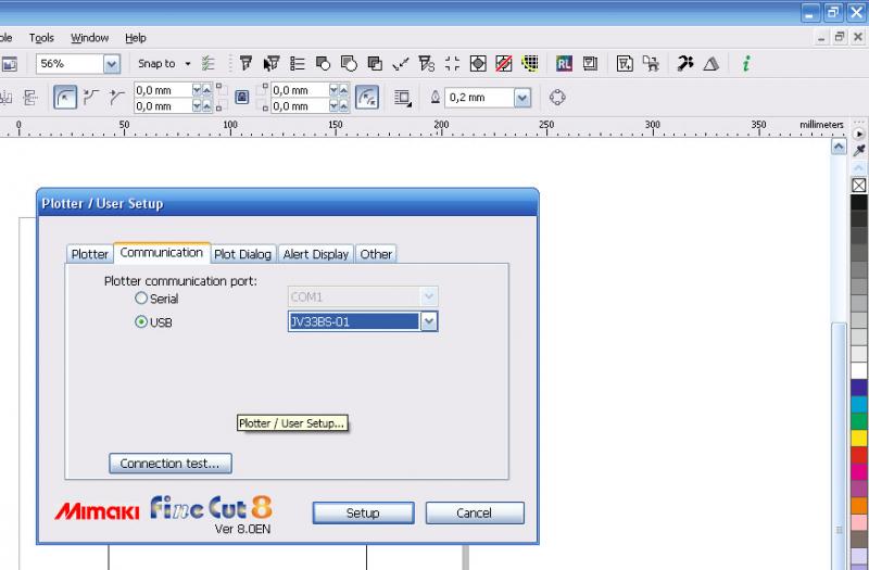

I had the same problem with my SR130.
3rd icon in Finecut toolbar - Ploter/user setup - mark USB in tab Communication. It will work just fine.
