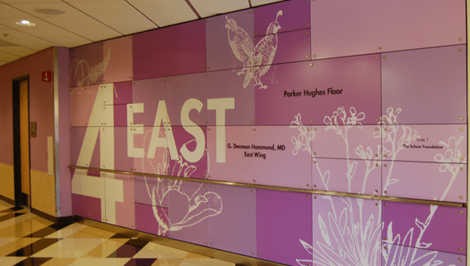

head during plan check. Here is a job I worked on
where all the materials had to be Class A rated.
The wall it's attached to is a 2 hour fire rated wall
that was modified to support the glass/stand off
structure. The graphics on this wall wouldn't last 5
minutes in a raging fire. but they won't accelerate it or
smoke the room up...
