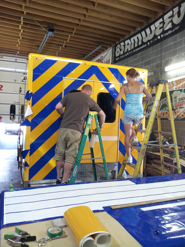

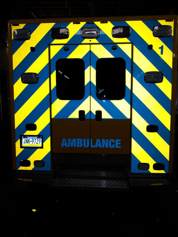

Yes, there are pre-made panels for those trucks. Only a few companies offer them, and they aren't cheap. They start with the lime green and overlay the red translucent. I've always done mine with strips of 6". Time consuming, but offers the same end look. If it's a new truck, have them leave off or remove the lights and any other additions to the rear - makes the panels go much quicker. And you must use the 3M DG3 - it's NAFTA standard.

We too, do it with individual 6" strips. Everything is removed and put back afterwards.

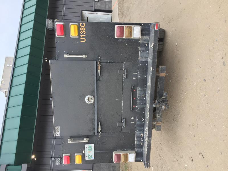

I think i did not explain it properly. its Emergency Management & Fire Safety (Government org) so they are not fire fighter only. Attaching rear photo of one of their trucks

I didn't catch that you were in Canada. NFPA for vehicles may not apply there. From a quick search it looks like Canada only adopted NFPA certification in 2014.. you may want to talk with the department to see if they are required to have DG3 material. Local emergency management teams around here are not required to have DG3, only active fire departments. Which may be a good thing for your project - those rivets will cause issues with the DG3, the Reflexite a little less. Personally, I'm surprised Reflexite carries the NFPA stamp of approval - in my experiments the reflective nature is much less than the DG3.

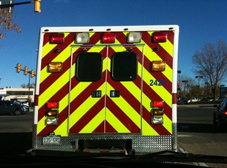

Orafol was demonstrating a new product at FDIC in Indianapolis (big firefighter conference) when I was there a couple weeks ago. They had sheets of pre printed red and yellow chevrons, that came in left and right sets. According to the lady I talked to it was repositionable and conformable. I'll have to dig through some stuff to find the brochure they gave me, but it looked pretty cool. I do a lot of chevrons printed on 680CR. There is a lot of confusion about it, but according to 3M, 680CR meets the NFPA specifications to be used for chevrons.
I believe that was "converted" material, FirehouseDecals.com sells it. It isn't repositionable or that conformable or air release like 680CVR though; unless they have a new product out. I'd definitely be interested in seeing the brochure.
